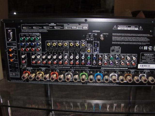

UK owner here had my 876 for nearly week now,so far very pleased.
Couple of pics.
