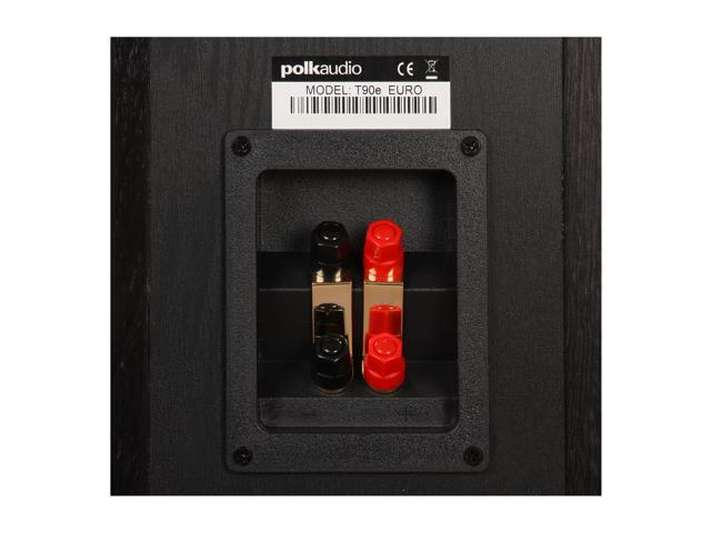

I received my pair of fronts (the T90e's) and I noticed that they have four posts for wire attachment, this is something that's new to me... all the speakers I have had in the past have been 2-channels... is there a particular brand or type of wire that I should be purchasing for these speakers? Yes, I know, I am a total newbie.

What type of wire would I need to match the four-post configuration of my new speakers? I am a little confused by all of this... there's 12AWG... 14AWG... 16AWG and so on... does the gauge of the wire actually make a difference when it comes to the sound output? Or is it just safer to use thicker wire because it is less likely to be damaged?
Also, all the four conductor wires say something like this:
14AWG CL2 Rated 4-Conductor Loud Speaker Cable - 100ft (For In-Wall Installation)
What does it mean when they say "For In-Wall Installation"? Obviously, it likely means for use inside of the walls of your room, but does that mean that it is not advisable to use this type of wire on the interior of your room? My wires will need to be ran along the floors, next the wall...
This is an image of my speakers' hook-ups...
First thing the 14AWG CL2 Rated 4-Conductor Loud Speaker Cable - 100ft (For In-Wall Installation)
is just for that, in wall. You don't need it. The 4 conductor would be for if you were going to bi-amp and your not doing that. Leave the jumpers in your speaker on(the gold bars) and depending how long your speaker wires are going to be you would problably be good to go for the 14 AWG. The longer the runs the heavier the wire you want to use. There used to be a wire run chart on Monoprices site telling you what guages are best for the length of run. I use 12 AWG all around on mine, but I am also bi-amping my speakers. Measure all of your distances and order more than you need, better to have too much than not enough when you order from the net. Hope this helps. Stephen Hopkins can also give you a lot of info with this question. I just prefer the 12guage and terminate all ends with banana plugs(soldered type). Also, if you do decide to go with banana connections you will have to pop-out those inserts on the top of each of your speaker terminals.
