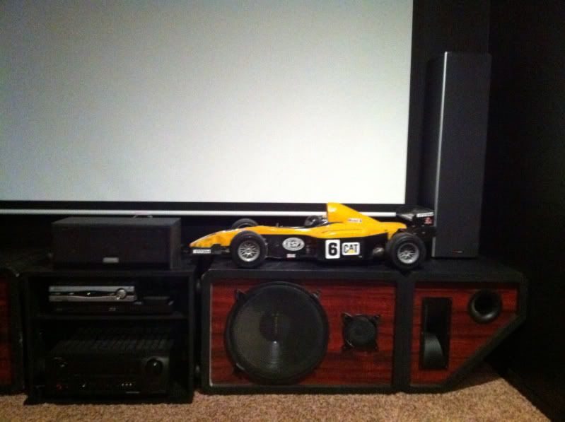

Here is the setup as of now. Due to the screen size I couldn't stand the towers up. I ran audyssey again and will give it some time before I change anything else. Thanks for the advice.

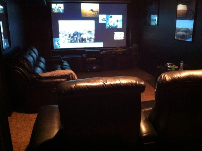

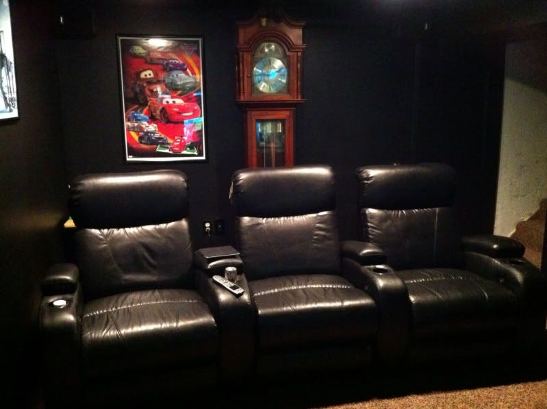

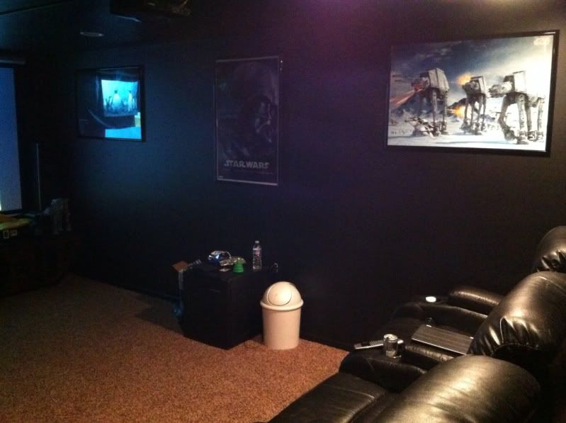

I know I straying from the 3310 topic, but I had to share the nearly final outcome. Still a little messy, but I'm in love.
