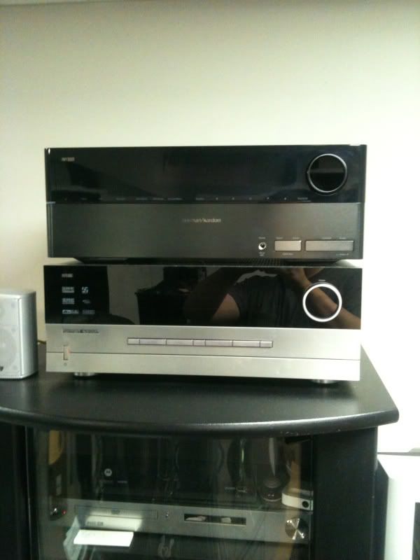

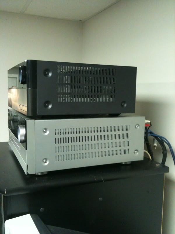

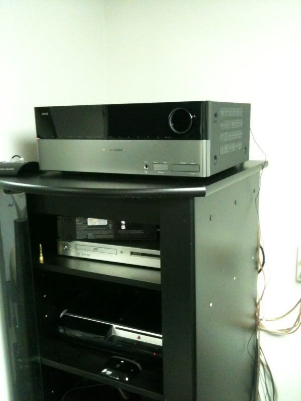

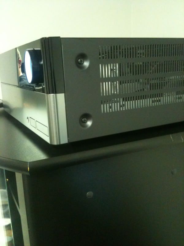

Did they change the colors on the 3600???
I unpacked my new 3600 (mfg date October 2010) an the lower half of the front panel is SILVER! On the 3600 I sent back last week the panel was black/gunmetal!
I guess that explains why the front port covers they sent me with my old 3600 didn't match the rest of the receiver!
Very strange... Unfortunately I kind of preferred the darker color of my old one even though I initially didn't really "love it".
Also odd: Initially when I fired it up the colors on screen were VERY off (missing blue) - but things look normal now.
-Aaron
English Way Cinema and Bar - moving on to v3.0... projector time in 2017!
PTAaron is offline
post #1525 of 2975 Old 12-08-2010, 09:58 PM
PTAaron's Avatar
Join Date: Jul 2010
Location: SE Michigan
Posts: 2,079
Quoted: 315 Post(s)
Liked: 357
Allow me to provide pictures:
New AVR-3600 built in 10/10:
Old AVR build date of 9/09:
-Aaron
