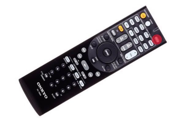

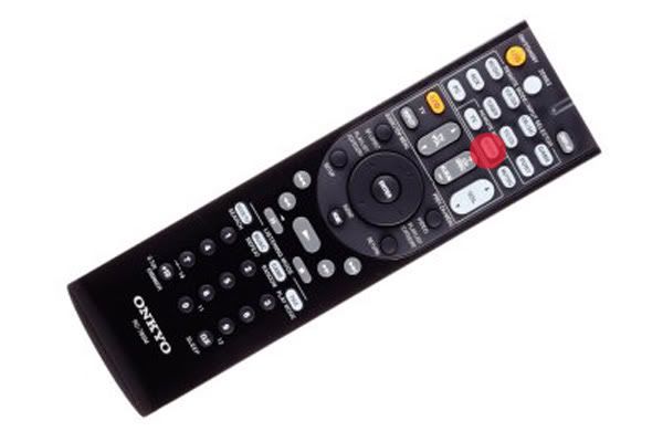

Here's how I got OSD to work, and I hope this works for you:
Hit your PORT button to get your iPod powered up.
Try pushing the "DISPLAY" button once or twice.
If that doesn't work, push the "receiver" button
and try it again.
