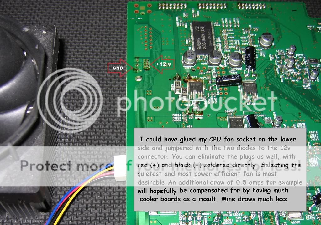

Many thanks to all. Between this thread and the one at High Def Forum, and $10 worth of parts, my 606 is back in action.
Would anyone know where we might be able to pull 12v DC so a PC fan could be added without the use of an external power supply, since my 606's HDMI board is already fully populated?

I also proceeded to replace capacitors and add some more to the regulators as advised by onkyo (with a lot of help from a friend, actually) and everything seems to be in order once again.
Thank you very much! I didn't have the money to buy a new receiver and I should sent it overseas to use the warranty. An expensive alternative also.
The question is:
Couldn't we use the main power converter for powering the fan(/s) directly from there?
(I am talking about conversion because I live in Europe and AC to DC converters are in use)
Wouldn't that be safer that messing around with the boards?
I see that there is not a combination to result 12 volts exactly, but I guess that it can be arranged more easily than powering from the HDMI daughterboard.
What are your thoughts about it?

The question is:
(First of all, good for you!)
It might be that you are referring to the big transformer with its multi-taps (AC voltages) and yes, one could connect to a tap and construct a mini-circuit of diodes/capacitors/resistors/etc to produce the desired 12 volts_DC (or less). I might address that issue here http://www.avsforum.com/avs-vb/showt...2#post19251082 as soon as I can. However, if you are talking of something totally different, then I may have much to learn about what is unique to each region, internally.
CZ_the_DAY is offline

Yes! That is what I am writing about.
I just do not know if the transformer is region independent or altered.

After much delay....
The transformer in my '576 has an alternate connection point for the 'mains' in - so my unit is capable of 220v operation. Another version of firmware would also be required for European compliance. I will try to provide alternate internal power options soon; without the luxury of a service manual, unfortunately...
