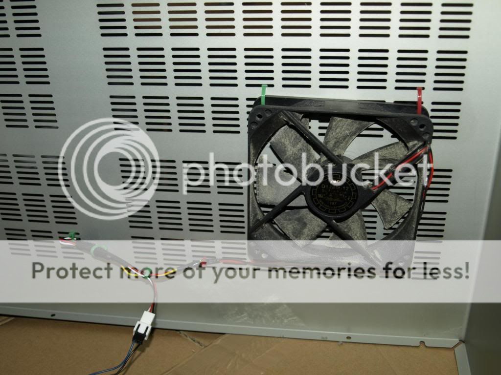

Posts: 4
Another satisfied customer!
*Cost to buy a new receiver - $600
*Cost for parts - $8
*Time spent repairing - 1.5hrs
*Receiver that works better than out of the box - Priceless!
My unit is an HT-R667. The issues I had were no connection to bluray, intermittent connection to Xbox360 (i would typically get compatibility errors), osd menu was off centered but the cable worked fine.
I replaced the (5) 100uf capacitors as mentioned by ghettosuperstar and this thing works flawlessly. I had time to fix today so I figured I would give parts from Radio Shack a try (272-1028). Instant connection to all hdmi ports on a cold start and osd menu is perfectly aligned. I decided to opt out on the bridges but did put a ventilation fan in. I did not test components as I don't use them. Picture quality is the best its ever been and audio is great. Thanks CZ for the detailed instructions and for getting this thread started; from the looks of it you've helped save many the frustration of buying a new receiver.
Jon Landry is offline
Good job Jon Landry. Take pics of your new cooling unit.

post #240 of 1085 Old 02-23-2011, 01:35 PM
stufq's Avatar
Join Date: Feb 2011
Posts: 4
Hi
As I have mention somewhere above I have been very successfully with my repair.
I have attached some pictures after replacing caps and fitting the fan. I had to use fan Speed Reduction Cable to slow down my 120mm fan.
stufq is offline
