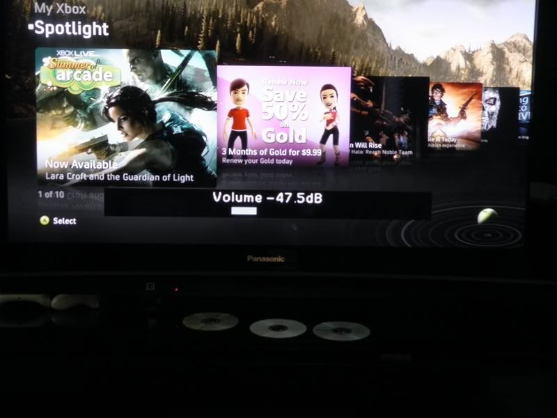

So you can display Surround Codec on the display panel and the volume overlay isn't really bad at all. Damn I love this receiver so far, more impressions as I play around.
090072 - The near is ending.

For reference ;
And it lasts maybe a second and a half. If that. I actually don't mind it and really I can see how some want the option to turn it off, but it's a non issue being as it's not nearly intrusive as some overlays from other AVR's, BD players and STB's,
