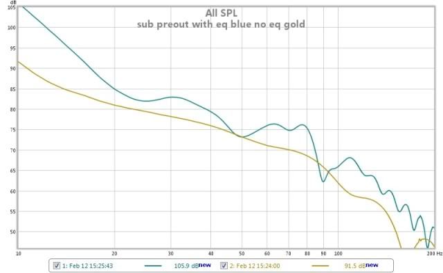

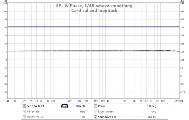

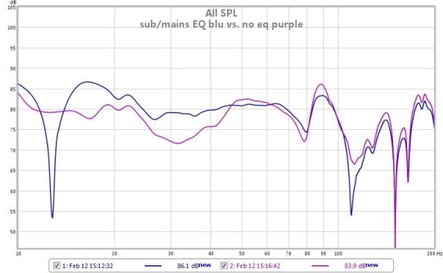

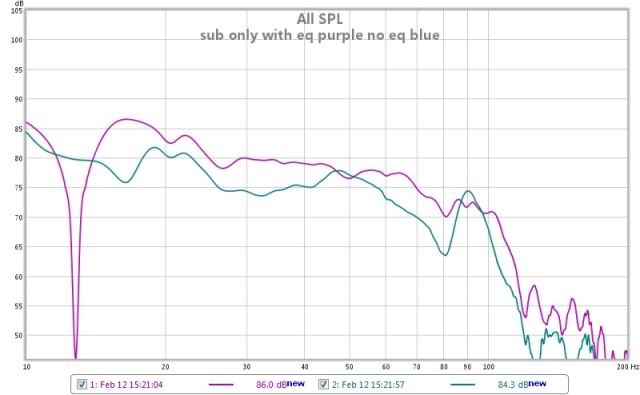

Markus, following are the REW graphs I said I'd run for you. Looks like you may have made progress on yours.
Please let me know what you think of these...kind of strange the downward slope of my sub with increase in frequency, but maybe that's normal?
From what I can tell, my UCA202 is properly calibrated.
Sub and mains with and without EQ
Sub only with and without EQ
Sub preout from 708 with and without EQ.

Thanks Floyd. Could you also check the second subwoofer pre out if it behaves any different?
Did you switch off Dynamic EQ and Dynamic Volume? Is Double Bass off? What's the crossover frequency of the mains? Which input did you use for the test signal? What listening mode was selected for that input?
Markus

I'll try to measure the other sub output. When I say "no EQ" it is with Audyssey off (Eq OFF), dyn eq and dyn vol both off, as well as double bass off. Crossovers are at 80hz. I used right channel for everything (UCA202, Aux input at 708 front panel). Standard stereo listening mode.
Do these look "normal" to you?
Looks like MultEQ in your 708 is working. The last graph is very strange. Is some kind of filter applied by the RadioShack meter? What's the frequency resolution of your graphs (hit "IR Windows")? It should be 1Hz or lower and depends on the length of the impuls.
