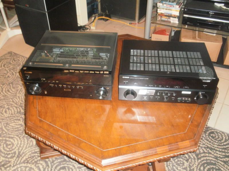

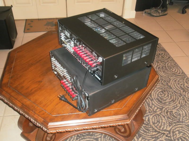

Originally Posted by Mikes2cents View Post
Gary, I think you know where I am coming from. Let me start out by saying I returned my 867 yesterday. It was not without some regret because I really liked how stupid easy it was to use and the passthrough and the remote was really cool and etc. I did this because I was not happy with the power output in a certain DVD I use for testing. I will say I adjusted a few parameters on the 867 and was able to turn it up all the way to +6db without it shutting down. However, the sound as before got muddy/sloppy as it approached 0db.
So the day before yesterday I removed it and put the Pioneer VSX-23TXH back in. It retained all the settings from before. I cranked it to +5db and it was just loud and clear and way louder. I am not so sure this is the difference in 15watts or the class of amplifier but a clearly audible difference.
Observations of the Yamaha, very nice quality unit. Good sound easy setup. If you are not a party idiot like me it will do all you need. My wife could do anything she wanted with the unit due to the standby passthrough and stupid easy scene buttons. I almost want to go back to the store and buy that unit for cheaper than I paid for it as an open box but.......
However it falls on it's face next to my Pio unit it was to replace. It does not have the power as I clearly saw on the top end where it struggled. It does not have the THX or Nueral (sp) options that really sound good to me, and it weighs about 5lbs less than my PIO. Call me old school but that has always meant something to me and I have been in the receiver game since 1981. Have a look, Yamaha on top:
I do not want anybody to get me wrong, the 867 was a very nice, capable unit. I just had the unfortunate luck to have a Pio Elite model before this and that is a hard act to follow. Sadly the wife has hated the 1.3 non-passthrough non-ease of use of the Pio from day one. Now as I look more, I see Onkyo is going to come out with their new units with the Marvel chip that supports even higher than 1080P. Where does it end? Guess I'll sit on the Pio and watch. Don't need another dinosaur in 1 year. I am getting tired of this crap.
Anyway, another comparison pic of the Pio that I am keeping for now.
Thanks for all the input from you Yamaha owners here. I was looking to go to this manufacturer and that is why I asked for input at high volumes. I did not need advice on how loud I should listen to AVRs that cost more than $500 but thanks for that too. I did like the 867 a lot. Glad I got to test it out. I am sure the Aventage units are good ones as well. Again, the 867 is a very capable unit for most apps. My app is in a 20'x24' room with a 6.1 setup and 3 Polk subs. Matter of fact, the speakers are all Polk monitor series except the rears which are wired for impedence making them one speaker. For now the Elite is staying despite it's user non-friendliness.
So let me get this straight, your Comparing a VSX 23 with a MSRP of $1000.00 and 110W x 7 to a Yamaha RX-V867 thats MSRP is 899.99 with 95W x 7 .
Hey i'm not trying to start a war here. Its a huge difference . I've own alot of pioneers and yamahas. I like them the same. But the fact remains the ICE AMP provides nothing more over another receiver with the same wattage specs .
A RX-A1000 is what you should be comparing that VSX-23 too and the A1000 is 5 Watts less a channel.
That pioneer VSX-23 is a good AVR. I own one and liked it for the 6 months I own it.
I believe I covered this in post #3087 but thanks. I only posted the pics because I had them and wanted to explain why I returned the 867 which I thought was a fine unit. It was very close to being a keeper so I did not want anyone to get the impression I did not like the AVR. It is a solid performer, I just was not about to step down in db although I probably ought to.
BTW, the VSX-23 does not have an ICE amp. It uses an advanced direct energy one per Pio lingo. (Or perhaps that is an ICE amp then because it sure does not get as hot as the 867 did. IDK)
FWIW my Pioneer Elite has a bunch of junk DSP modes I never use as well. However, I use the crap out of my THX, Neo, and Neural settings because my cable Co broadcasts in the lowest they can get by with as far as sound. My HBO and Skinamax channels come on low def pic with stereo signal except for 2 HD channels. That stuff needs help.
