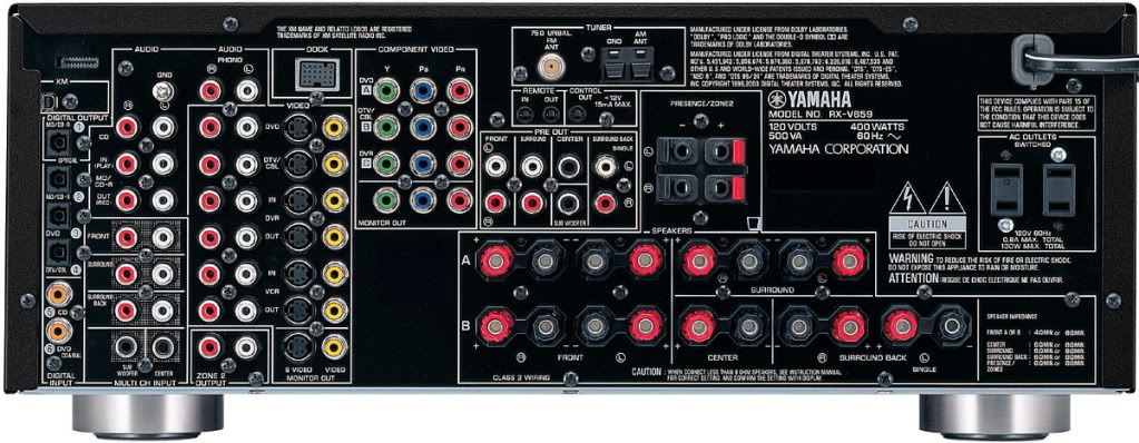

One thing these three new receivers don't have, is switched AC outlets. Not a deal breaker, yet on my RX-V659 there are two of them and I use them for running two sets of fans.
RX-A3000
RX-V659
Blasst is offline
post #109 of 9258 Old 08-15-2010, 01:38 AM
SoundChex's Avatar
Location: USA, west coast
Posts: 3,334
Quoted: 346 Post(s)
Liked: 294
Which omission makes moot the question of whether any such outlets should be ON or OFF when the RX-A3000 is in "Standby + HDMI Pass-Through" mode...!?
In any event: If you are really considering upgrading from an RX-V659 to an RX-A3000, you might consider retaining and 'repurposing' the RX-V659 to provide amp power for 4 (to 6?) of the 11.x channels that the RX-A3000 can deliver from its pre/pro front-end . . . and you would still be able to use the RX-V659's switched outlets to control your fans...
