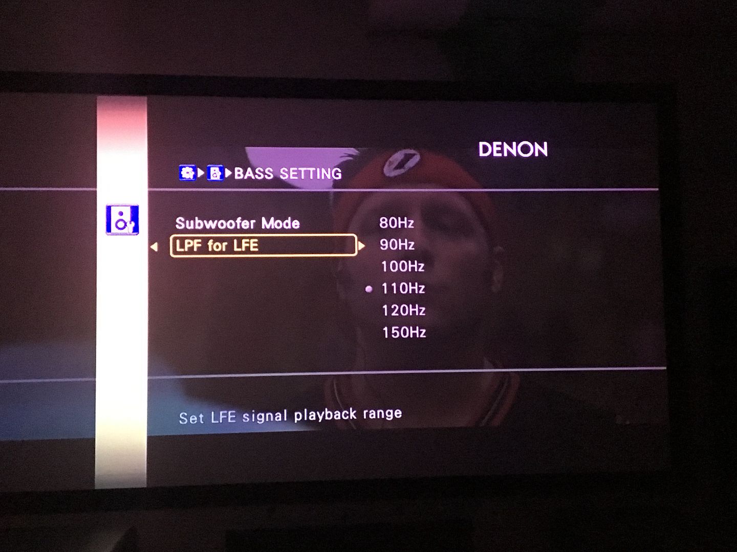

Does anyone know what this setting does for the subwoofer, there's already a crossover setting, I'm a little confused...
Also what is everyone using for a setting or what is the default setting?

It's not a crossover, it's a separate low pass filter (LPF) that's ONLY for the dedicated LFE channel (the "point 1" in a 5.1 or 7.1 signal).
The subwoofer reproduces two things: (1) LFE content and (2) the redirected bass from other speakers which have crossovers. It combines these two inputs and that's what gets sent to the SW pre-outs.
So for example let's say you have all speakers set to small and set to 80Hz crossover. The subwoofer will get all bass below 80Hz redirected from those other speakers, and it will ALSO play back the .1 LFE channel on a multich soundtrack. The LFE channel only ever goes to the subwoofer.
So that setting controls the upper end filter for JUST the LFE portion. The crossovers you set on each speaker control the upper end that the sub gets from redirected bass, and the LFE LPF setting you are asking about controls it for the .1 channel.
Typically the advice is to just set it to 120Hz and forget about it.
