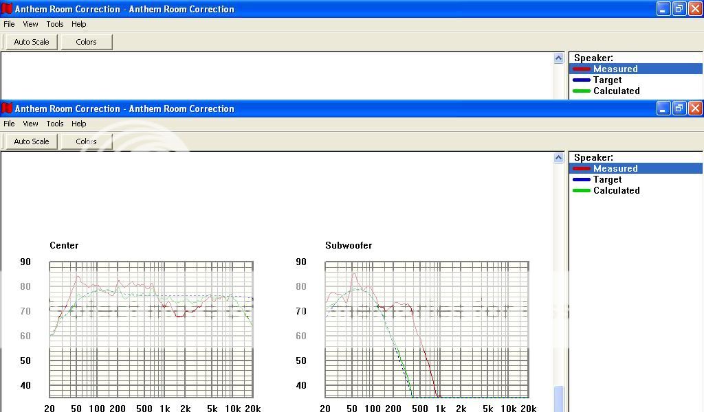

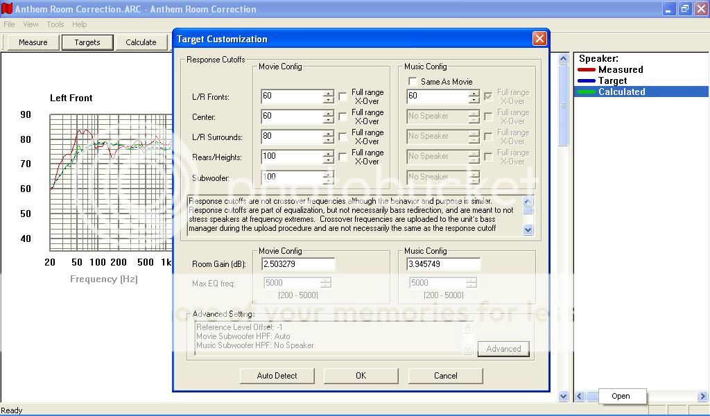

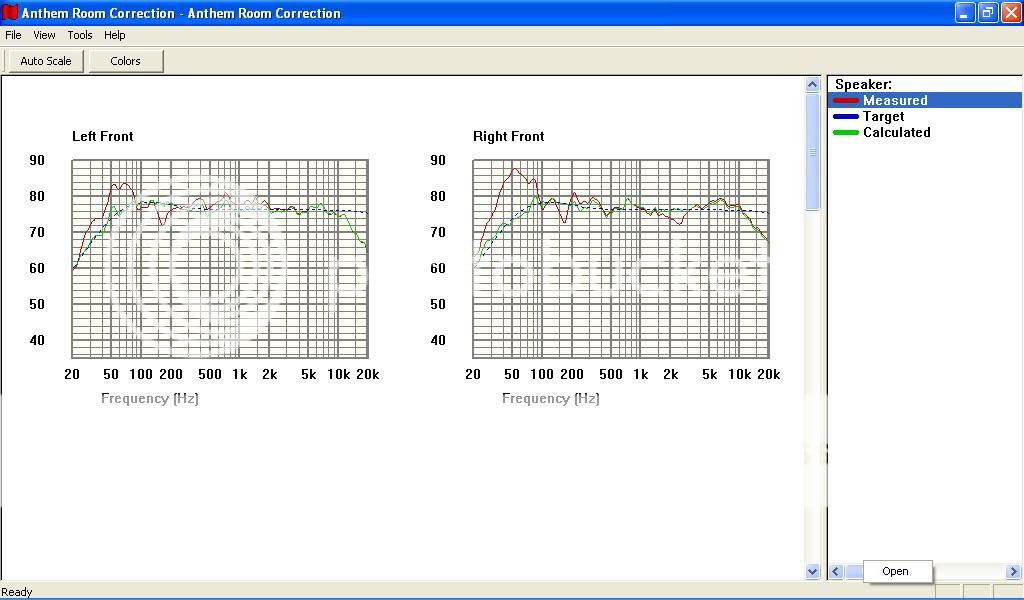

I finally ran a proper ARC tonight with my subwoofer back from servicing. I've attached the charts below - can you guys please provide some feedback on how they look and if there's anything I should tweak?
Also to clarify - do I need to run "Quick Measure" every time I want to re-run ARC to reset levels? I previously ran ARC before tonight shortly after I got the MRX500 but I couldn't run it with the subwoofer which needed servicing. Therefore my MRX500 had an ARC file uploaded to it. So when it ran the test tones tonight, I'm assuming it's doing so with ARC off?
Secondly, I have Totem Forest floorstanders for my front mains. I'm guessing the full range capabilities of these speakers is why ARC set the cutoffs at 60Hz? The problem is that I had to dial the subwoofer volume to the 9 o'clock position because the ARC program indicated that the subwoofer was too loud. It also set the subwoofer level to -8. This coupled with the front mains AND center speaker being set at 60Hz cutoffs means I can barely hear the subwoofer now! Any advice on how to reconcile this?
Anyways, here are the charts - thanks in advance!

Hi,
overall the charts look good. The only thing that stands out is the big dip from 1-5kHz on the center channel which ARC tries to correct for. Where is the center channel situated in reference to the microphones?
Normally you shouldn't adjust the subwoofer volume after ARC has set the channel measurement. Did you check the phase setting on the subwoofer?
Cheers.

The center channel sits on top of my a/v console which is about 11 ft from the listener position, same distance as the main fronts. I do have my small HTPC adjacent to the center speaker on one side because I don't have room right now to put it inside the a/v console. Do you think that could be the cause?
I've toggled the phase switch from 0 to 180 degrees and I can't notice any differences.
I noticed that ARC set the speaker levels at anywhere from +6 to +9 for all the speakers except for the sub, which was set to -8. The funny thing is that the first time I ran ARC a month ago (without the sub), ARC only set the levels at +1 to +3, so I don't know what has changed to have caused ARC to ramp up the speaker levels so high compared to last month. Actually, one other difference is that I put the microphone on top of my L-shaped sectional instead of in front of it because the chaise part of the "L" makes it impossible to place the microphone for position #2 or #3 if I chose the microphone placement for in front of the sofa.

lpw, I believe ARC has to set speaker levels within the MRX's useable range. It appears that the your sub internal volume was set way too high, so ARC compensated by raising the levels of the other speakers to bring the sub within range. I suggest backing off the sub volume and then rerun ARC. As far as the sub volume not being to your liking after ARC, just bump it up until you are satisfied. Some folks, actually most, prefer to run their sub hotter than what many correction systems suggest. ARC nailed it for me, but with my former Audyssey equipped AVR, I had to bump it up a couple dB afterwards to get it right.
BRAC is offline
I will second this suggestion. I had an issue where my D1 got confused about the trim settings, a factory reset fixed it. If the levels are really starting that far apart you need to fix. If not do a factory settings load.
Hi,
I was thinking that perhaps the center channel was pointed too low or too high for the microphone (e.g. on top of the TV or below it but not angled to provide the right elevation to position the tweeter at ear level). What brand/model of center channel do you have?
As for the reference levels it is hard to say. For the subwoofer the volume knob may be too high which is why it is adjusted within ARC. My subwoofer volume is at about 9 o'clock on the dial and ARC has adjusted it by -1 dB. For the phase find some good signals with repetitive low bass (>30 and <60Hz) and then either switch it yourself or ideally have someone toggle the phase switch from the primary listening position. You will definitely notice when it is in/out of phase.
From what I have read in the ARC post in the forum and through longtime forum ARC experts (e.g. Bob etc.) and based on the picture in the ARC manual it is recommended to have the microphones in front of the sofa backs etc. and at ear height. You can put the microphone above the sofa back as long as it is a few inches higher and pointed straight up. When sitting on the sofa my ear is approximately 41" from the floor so I setup the microphone on the tripod with the tip at exactly that height to make the measurements. As my Revel C12 center channel speakers sits under my TV I put some risers underneath it (shaped like a door stop) to angle it so that the tweeter is aimed at the primary listening spot. You can easily verify this with a laser pointer held alongside the outside of the center channel speaker at the same height as the tweeter and then pointed at the microphone. This helps optimize the speaker/listener locations so that ARC has the best conditions under which to perform its measurements.
Hope this helps.
Cheers.

Thanks Tony, Brac and video_bit - all great info! I will re-run ARC with some of those suggestions. The only other annoyance that I have is that my MRX500 has randomly "locked up" more than a handful of times. I have the latest firmware and software. Another poster mentioned this about 6-7 pages back about this same issue so I'm wondering if more of you have encountered this.
Basically, the MRX500 will be on and working fine, and then it will not receive any commands from the remote and even pressing the power toggle button on the unit's front panel has no effect. I have to unplug the power cord and plug it back in before normal operations can resume. Similarly, I've had instances where the unit is in a powered-off state and it won't turn on through the remote or the power toggle button on the front. Again, I have to unplug and then plug it back in before the unit works properly.
When I was uploading the ARC file to the MRX500 last night, it actually powered off in the middle of the upload! I had to unplug and plug it back in so that the uploading could resume and complete. Weird. I've emailed Tech Support and I'm waiting for a response.
lpw is offline
