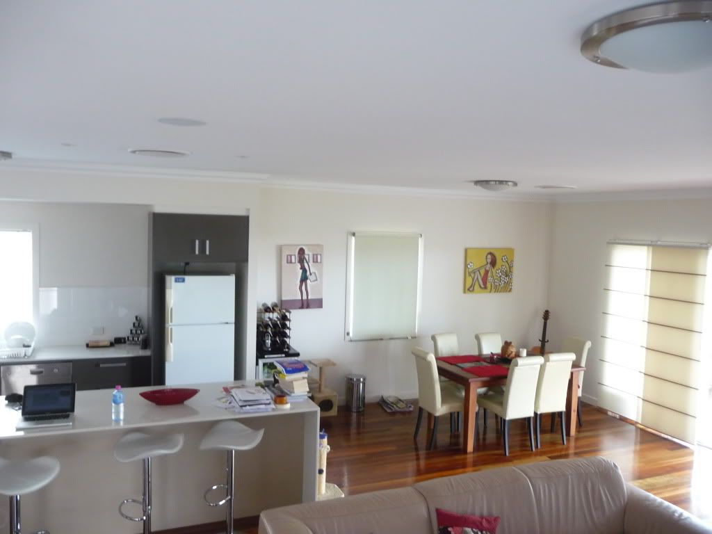

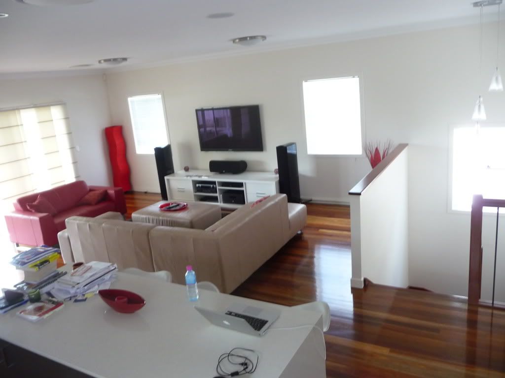

i forget... what's your room "look" like? dimensions, openings, etc.? how are the speakers positioned in relation to the walls and you?
The room size is 9.0m (29.5') across the front (in line with the front speakers) which included the void over the stairwell, and 7.5 m (24.5') front to back. I've added a couple of photos. The ceiling is 2.7m high (9') and the floors are polished wood with a rug in the central area. The rears are ceiling speakers because of the size of the room
Any suggestions for acoustic panels?

Many, starting with a rug and bass traps, but check out all the info on www.realtraps.com. Ethan posts here often.

Steve,
Bring your speakers forward. The center speaker should be at the front of that entertainment cabinet, you are reflecting sound up from the cabinet as it is now. The L/R speaker bring them out more to the sides so they are not right against the cabinet and if you add drapes slightly in front of the windows. Also, bring them forward to be even or slightly in front of the cabinet and toe them in slightly towards the main listening position.
Your room looks pretty live and bringing down the overall reverberation in that room would help a lot. Heavy drapes/curtains (or acoustic shades - expensive) for the windows and sliding glass doors would help. The artwork you have behind the table could use some fiberglass behind them. Other art elements like that would help.
I'm not sure how thick the throw rug is but a thick throw rug with a pad under it would also help.

Bob,
Excellent advice! I looked at the pictures of Steve's room and did not focus on the location of the speakers. Something as simple as moving the center forward and moving the R&L speakers out from the stand and forward will be a big help. There is definitely plenty of space to make all those changes.

Steve,
Looks like a Very Nice EMOTIVA Amp there. Your FR/FL speakers should be out farther from the CL of the TV, and not symmetrical about the Centerline (CL). Make sure they are off the wall a foot or so from the back of them to the wall - looks like they could be moved forward and be flush to the face of the cabinet.
Where's the nice Subwoofer or better yet two of them?

Hmmm..... I believe that advice has already been mentioned. What do you mean by "and not symmetrical about the Centerline"?

I try to place my speakers a bit forward of my AV furniture with the idea to avoid interference. Not sure important that is - acoustics is somewhat of a mystery to me with that boundary interaction stuff.

Thanks Guys,
I've moved the speakers to the front of the AV cabinet which gets them about 15-16" (at the back of the speakers) off the back wall. It does seem to make a noticeable difference.
I'll put roman blinds on the windows (2 at front and back) made out of heavy fabric - this will also help with light control during the day (only venetian blinds there now).
The rug in the centre is thick shag pile it's about 5'6" x 7'6" - is that enough for floor coverings??
Maybe the artwork on the back wall is a bit small and a larger piece is needed.
The Sub is 12" and out of view behind the half height wall. I'm not sure about the centre channel being off centre?

Originally Posted by SteveD61 View Post
Thanks Guys,
I went to Hifi store nearby on the weekend who carry mostly hi end gear. The salesman really knew his stuff and really stressed he importance of a power conditioner to improve sound quality and reduce the noise floor - is the power conditioner going to deliver SQ improvements that you can notice?
Again guys thanks for the good advice.
Did you move the FL/FR speakers out to the sides also? Space them out left/right different distances from the centerline (listening position), in so that they are asymmetrically spaced, then Toe-In On-Axis, then run EQ again.
Forget about the Power Conditioner, unless your power there is junk with noise, dc offsets, etc. IMHO, just make sure you have a good Surge Protector or two of them if needed.

DenPureSound, your statements require some clarification regarding "centerline," which is not synonymous w/ "listening position," and "asymmetrically spaced" loudspeaker placement.
First, true, L/R loudspeakers need not be symmetrical about the centerline of the room. In fact, symmetrically placed L/R share the same room modes, hence they cooperatively exacerbate those room modes. But asymmetrical placement can help mitigate room modes by distributing them in frequency and lessening them in amplitude.
Additionally, the listening position need not be on the centerline of the room. However, it does need to be on the centerline of the L/R loudspeakers. In other words, if L/R are symmetrical about the centerline of the room, then the listening position needs to be on the centerline of the room. Conversely, if L/R are asymmetrical about the centerline of the room, then the listening position can be off the centerline of the room but still needs to be on the centerline of L/R. The centerline of L/R is the only location that experiences proper stereo imaging in both amplitude & time.
All that said, SteveD61 has an irregularly shaped room. Review his room photos. His L/R loudspeakers are already well off the centerline of the room.
