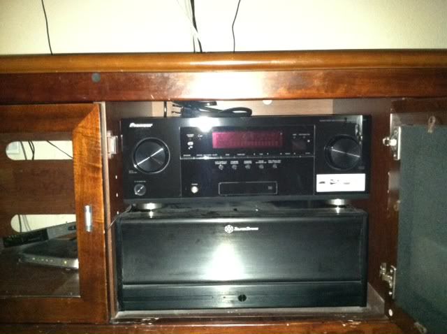

I picked this up on Newegg Friday, it's on the truck! I haven't had decent sound in about two years since I had to stage my house for sale for a job transfer. Staging person said I needed to get rid of my speakers so I gave them to a buddy and the old Onkyo was on its last leg so I gave it to goodwill. Ive been limping along with some Klipsch Promedia 2.1 speakers plugged in via headphone jack. Fast forward 2 years and I found this receiver for $299 and the Martin Logan MT-2 speakers for $299 so I ordered. I've read every post and it looks like I'll have a monumental task on Tuesday or Wednesday. Luckily I have my cable modem next to the TV so no bridging and or wireless issues as I'll be hard wired in with a gigabit switch. My setup will be:

I bought an extra HDMI cable, 14 awg speaker wire, banana plugs and sub woofer cable for LFE. I think I have everything. I'm going to be running 3.1 for the moment until we move out of this apartment. We really dont have a good setup for 6.1 yet. Eventually I hope to have more zones with the use of airfoil. Hopefully this will go smooth and I didn't forget anything for the setup.

post #1799 of 2750 Old 02-08-2012, 04:43 AM
cadsystems's Avatar
Posts: 380
Everything came in but the banana plugs and speaker wire. Amazon is sending me a $10 gift card for my trouble. I guess prime does pay after all. I have a bit of an issue with my entertainment center. My middle bay is the largest bay and that's where my HTPC and Pioneer will have to live.
Here's a pic:
I cut out the back side of the entertainment center in the middle, do you think i'm going to add a fan or anything? I don't run the HTPC 24/7 mainly on the weekends only for a short time.
cadsystems is offline
