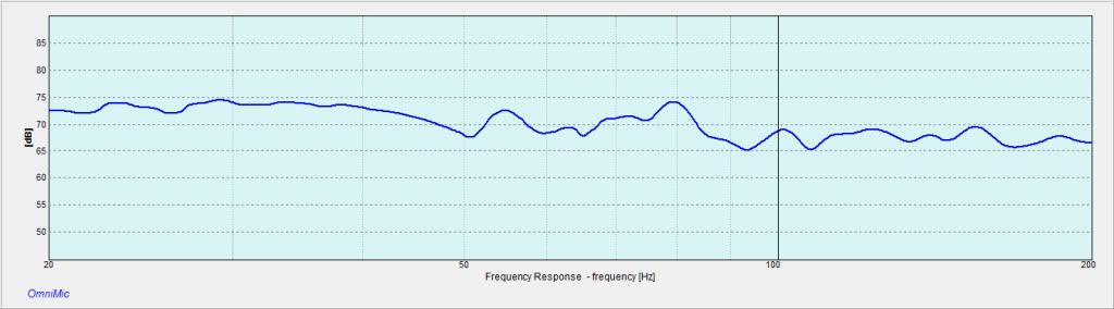

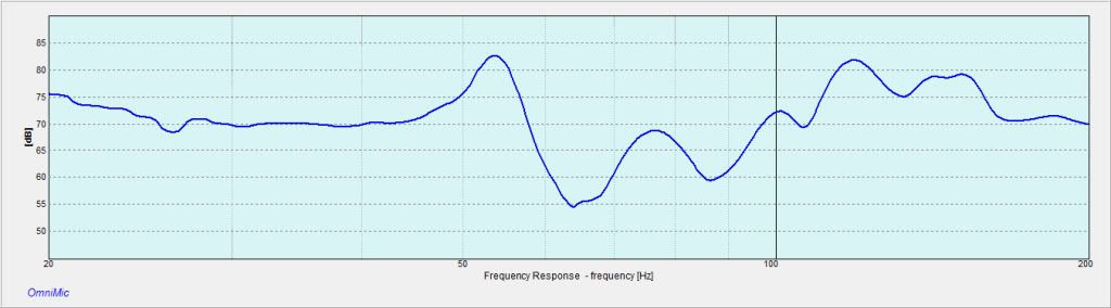

I'm the last person to ask, Jeff My No 1 suspect is me. User error. I have abandoned waterfalls for the time being until I get some better idea of how to use them with OM.
In fact, I have now done about 6 Pro calibrations, mainly experimenting with mic positions around the MLP and I now have a superb result. It is the best I have ever heard my room sound. Detail is staggering, clarity is amazing, soundstaging is incredible - my room seems bigger than it is, the sound is entirely detached from the speakers, the bass is tight and controlled and stops and starts on a dime. I am currently a very happy bunny. So much so, I am ceasing doing measurements and calibrations for a while now and am just going to enjoy some movies for a while.
