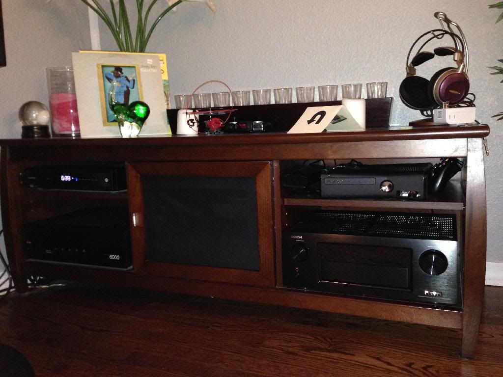

Originally Posted by pg_rider View Post
Back to the heat discussion, I wonder if my receiver would prefer more ventilation above it? I'm literally amazed that so many are reporting lukewarm temps given how hot mine runs...
It looks to me like you have sufficient room on top; it's the tight clearance on the sides and back that are probably causing insufficient circulation.
I have even less room around my AVR-3311, but I cut out the back to the cabinet in the dimensions of the AVR and it runs lukewarm all day long. I would recommend you try the cutout option first and then add the fan if it proves necessary.
