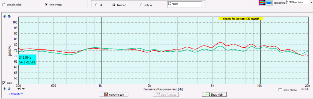

This is what Audyssey xt32 does to the highs in my room. Red line is Audyssey on, green line is no eq at all.
Both are 1/12 smoothing.
With Audyssey on the sound is pleasing at first but quickly my ears get fatigued which makes sense because Audyssey is boosting the highs.
Now, I do have very nice compression drivers in my speakers. I have heard Audyssey in another room with dome tweeters and the sound was much improved with Audyssey on, so it could be that audyssey doesn't work well with compression drivers in the high frequencies.
I do love dynamic eq, but no audyssey eq for me for now. The reason I'm following this thread is because I'm curious about other types of room correction/eq and I've heard nothing but great things about Dirac.

What does that graph show? Windowed? Which speakers? Calibrated mic?
For 1/12 smoothing it looks way too smooth.
Left speaker only - not sure what you mean by windowed.
Yes, my omnimic is calibrated.
1/12 smoothing. With 1/6th it's almost a straight line.
I'm lucky (and I've done TONS of experimenting with speaker placement/main LP placement over the years), I get a real nice response now at my main LP. I do have room treatements (GIK Tri Traps from floor to ceiling in each front corner, 2 GIK panels on each side wall for first reflections for each speaker, 3 GIK panels on the ceiling for first reflections).

The sweet spot is the front row right seat, that's where the mic was.
Selecet "all" instead of "blended".
Oh, I see. The setting was on blended, that's all I've ever used.
