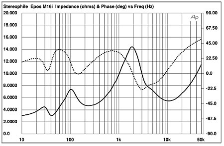

Please help me choose an AVR
Hi!
Can you please help me choose an AVR?
- I won't have the chance to listen to any gear before buying
- I will be using the AVR mostly for music
- My room is medium, but opened to another large room,
- I will need room correction as I will not be able to use any room treatment and the sub (SVS SB-2000) will be placed further in a corner.
- My speaker setup is 5.1:
Fronts: Epos M16i with nominal impedance: 4 ohms. Sensitivity: 88.3dB/2.83V/m. Amplifier compatibility: 50–200W.

I have no experience with room correction I have read just the online reviews and forum hype. I have used different audio systems and HTIB - none of them had EQ room correction and I usually liked the sound (if I didn't the problems were due to the bundled cheap speakers). The only reason I am considering more expensive AVRs is the much hyped Audyssey XT32 and the presumably important bass management that it does.
Some owners mentioned that the Epos M16i may sound bright with more harsh receivers. Are all receivers sounding the same as many blind tests show or is it true that some receivers sound more harsh and other sound warmer? If so the H/K and the Arcam will give better synergy with my Epos M16i/M5i I guess (Anthem and the newer Marantz receivers don't seem to be considered warm or laid back).
One important question - all my music is in lossless format (FLAC, WAV, etc) would the H/K reproduce these from a HDMI, USB or network source?

Anthem is on my list exactly because of the highly regarded ARC.
On the other hand I am not quite sure how it would drive my 88dB, power hungry speakers which occasionally go below 3.5 Ohm - the Anthem amp section seems to show significant distortion quite low on the power scale with 8 Ohm and 3.5 Ohm might be too much. I am sure the amp will drive my Monitor Audio Silver 10i center and perhaps the 4 Ohm Epos M5 surrounds, but the Epos M16i fronts might be too much to drive to reference levels. Do you have any info on how Anthem works with lower impedance?
