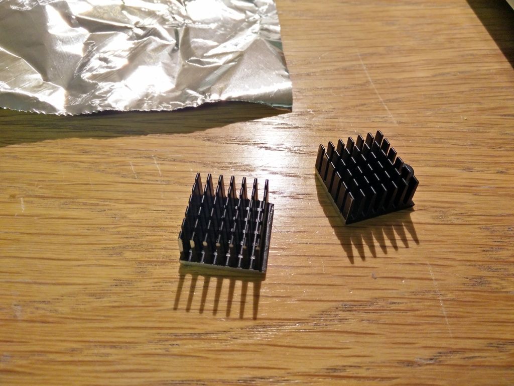

Same problem, did find a web site where people are getting a temporary fix by using a heat gun on the DTS chip for 20-30 seconds. I did this and it worked for a couple of months, then had to redo it but only gut a couple of weeks out of it. Just had to do it again.. but not expecting it to stay fixed for very long.

Posts: 25
Originally Posted by Edllguy View Post
^^^Which chip is the DTS chip?
These two here.
I've just cut an old heatsink to go on top of them. Haven't got round to reflowing the chips yet.
UPDATE:
I've done the reflow and attached the heatsinks on using some thermal adhesive - unit powers on without error. Only time will tell how long it takes for the error code to come back...

Just thought i'd report back on how things are going after the heatsink addition. Since my last post, the receiver has been playing the Inception blu-ray on endless repeat, and since 4 hours ago things were dandy.
Then I decided to point my 40W desk lamp, about 16" high, towards the decoding chips to see how it'd react - the reason why I did this was because I thought A) i'd push the unit to see how it'd cope and B) the cabinet that this unit normally sits in gets warm when both the receiver and the HTPC are running. I have gotten fed up of taking this unit out of the cabinet so I recently ordered some cheapy banana plugs to make life easier. Anyway, about an hour ago the UE22 Error came back but the audio was still going. Switched the unit off and back on again and the error went away - audio continued to play with no crackling.
Does this evidence strengthen the idea that the UE22 error is to do with dry solder joints, and that heat is causing the problem to re-occur? Explains why some people leave their units alone for a while to find that the error disappears when they power the unit on.
For the heck of it, i've now installed a 40x40mm fan and used some Kapton tape to help channel air through the heatsink fins. The fan will be powered via the 12V rail from my HTPC which usually sits on top. For testing purposes i'll probably hook it up to a 12V transformer.
Yes, I'm clutching at straws, and whilst most people would just go out and get a repair or buy another unit, I'm a (just graduated) student with an interest in hi-fi/audio who saved all my pennies to buy this on the day of release. I'd rather do some DIY/have an argument with Pioneer to keep this going until I can afford something shiny, but i'll be looking elsewhere...

The last pix shows the fan blowing toward the rear panel...
Since the power supply is in front of the fan, the fan is taking the hot air from the power supply and circulating this to the already heated ICs..
U may have better results by reorienting the direction of the fan's airflow..

Thank you for your suggestions.
Your reasoning about the fan stands perfectly, I thought this also when deciding which way to position the fan. The reason why I still chose to place the fan in a "push" configuration was because the transformer is sectioned off by a metal panel and beam - you might be able to spot it on one of my previous pictures. That transformer does get very hot indeed (shouldn't they be more efficient in this day and age?), but it seems that there is no way for hot air to reach to the back of the unit where the circuitry is. Additionally, as this fan doesn't move much air, pulling heat away may not be as effective as pushing air over it. I've always wanted an IR laser thermometer, maybe this is the perfect excuse to buy one and experiment!
Your second point is something I should have done a long time ago and this is me probably paying the price now - stacking is my only option however. Whats the best way to add clearance? Would adding "hifi style" feet underneath the existing ones on the HTPC look silly?
