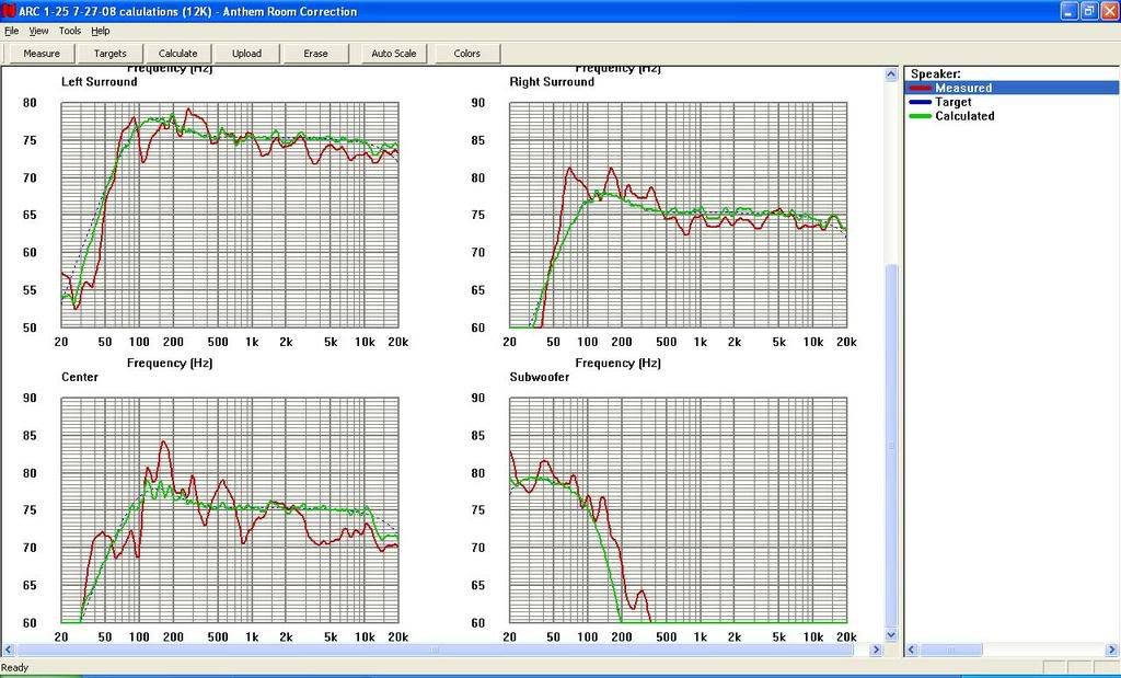

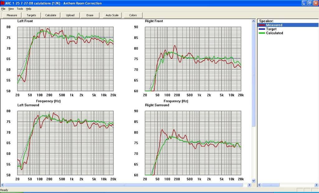

Here are my 12 kHz graphs. dipoles for all back and surround.
Looks good to me! You still have a few dB drop in your side surrounds at 12KHz but nothing to worry about in my opinion. I am surprised, though, that ARC didn't roll off the Target curve up there for your dipoles.
I guess we still haven't figured out just when and why ARC rolls off the Target curve up there for some folks.
Your Measured curves still show some pretty dramatic room response issues around 100Hz to 150Hz. But ARC seems to have that under control even in your 12KHz calculation.
--Bob

Bob,
Well it sure sounds good and if I close my eyes, I can't see the graphs but I can sure hear the sound
John
--Bob
The dropoffs were greater with 5 kHz. They were raised with 12 kHz. May account for the better surround effects.
You have mentioned the use of ARC resources when raising freq. to 12 k. I thought the LFE sounded very good and probably same as my 5k results.
John
Jayray
Read the FAQs
jayray is offline
