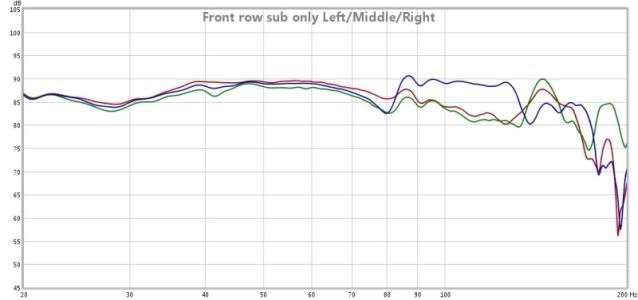

MIke, that's how I run mine with XT (optimize for first row). For my 3 seat front row, first is MLP middle seat, next left and right seat, next in front of left middle seat arm rest, then directly in front of middle seat, then in front of right middle seat arm rest, and the last two right behind middle seat on left and right edges.
Seems to work well for me so far. My back row gets used infrequently enough that I'm not that concerned about it.
Here's front row sub response at each seat:
Floyd, Nice 1st row response, I take it that is with Audyssey and sub only as marked. Is that blip at 80hz due to xover or?? I also see 120hz, is that your LPF setting?
Curious, do you also have:
-Sub +mains w/audyssey
-sub w/o audyssey
I re-ran my audyssey this morning, will take REW measurements tonight/early tomorrow.
Note that XT32 only uses 8 measuring points as well. Regardless of where your actual seats are, the general guidance from Audyssey is to place mic positions 2-8 within a 2'-3' radius around the #1 main listening position.
Thx, it's been a while since I read the set-up guide, I've re-read it.
I did just 1st row this morning, all 4 seat positions, 4 @ ear position lying down, and 4 more about 20" fwd or so, like if the seat was fully upright and you were in that position for sports watching.

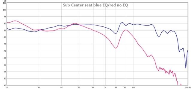

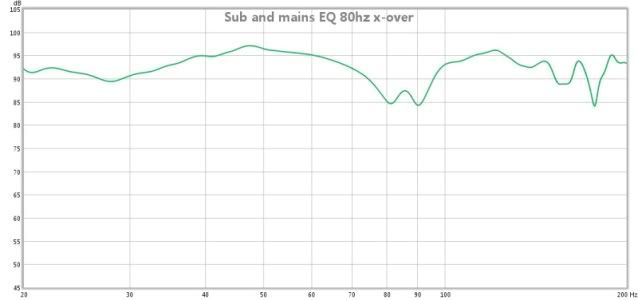

-sub w/o audyssey
Here you go Mike. I haven't taken a ton of measurements yet with my new 'TX-NR809. All of these were with 120Hz LPF.
Here's sub only front center seat with and without EQ. The blue trace with EQ is 200Hz x-over and the other is at 80Hz.
Here's sub and mains with EQ and 80hz x-over.
I've always had a dip at around 80hz at MLP even with my previous receiver (TX-NR708). Had good luck getting rid of it with sub distance increase but just haven't had time to fuss with it yet with the new receiver.
