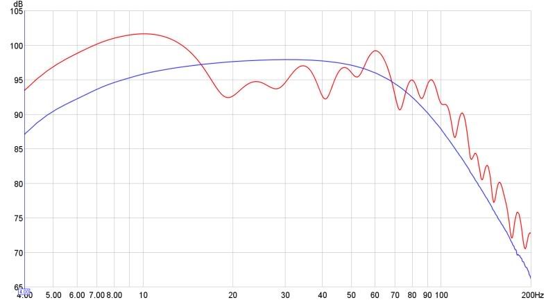

Originally Posted by mogorf View Post
Hiya Craig, with all due respect, in your post there is no real convincing evidence whatsoever that could be taken for granted, i.e. unboubted reasoning wholelly discribing the true reason that it was the normalization effect below the -3 dB point of the sub caused by Audyssey that lead to a friend's catastrophe. Agree?
I agree that I haven't given you any "convincing" evidence... well at least not any evidence that would convince a "true believer". If you don't want to believe my account of my first-hand experience with this problem, that's your prerogative. I know what I experienced and that is all I need to know to be convinced that this can be a real issue.
Again, IMHO it is the deep reasoning what is still missing from this description.
Do you need more "deep reasoning" evidence than this:
Ricci's graph:
If you do, it is confirmed here:
MACCA350's graph:
Both of these graphs show added gain below 20 Hz due to the normalization process.
If you want to stick your head in the sand and ignore the obvious, please feel free to do so.
Craig
Ricci's graph:
MACCA350's graph:
Craig
They will say room gain, unless you have a picture of you doing the measurement in real time LOL
My guess is head in the sand.
I really like Audyssey, but it has flaws like everything else in the world...except here

Originally Posted by lou99 View Post
Audyssey team,
I have a question on calibrating a small room using Aud.XT.
My room is about 12x20 (with about 7' dead space to the right of the sofa). Below is a image of the layout, and the recording positions based on my understanding of the how-to's.
Questions:
1) Audyssey recommends 2-3ft between measurement locations. In my case, that means that the 1 2 3 4 5 6 will be pretty close to my TV and far from the sofa. Is that OK? Could I get away with 2 feet wide, but 1 ft long spacing?
2) Are my the measurement points for 7-8 ok?
3) Ear height in my scenario is below the seatback. Should I take all measurements above the seat back?
4) Do you guys have any tips in accurately measuring distance with a boom mic stand?
My room is similar to yours in that it's setup wider than it is deep.
My measurement technique which has been tried by quite a few folks here, is to take the first measurement on the couch 18" from the couch back, and centered between the front left and right speakers.
Measurements 2 & 3 are taken to the left and right about 2' from 1, provided this does not exceed the width of the front left and right speaker positions.
I then take measurements 4, 5 &6 from left to right as you look at the TV, one to two feet in front of locations 1-3. Don't take measurements closer to the front speakers than half the distance between the center channel speaker and position 1. This produces an angle that's is too great from the farthest front speaker when measuring on the left or right as seen in your diagram.
Take measurement 7&8 in the center of the boxes formed by 1, 2, 4, 5 and 1, 3, 5, 6.
Those are pre-out measurements, so the room is not involved. Those are from the voltages directly put out by the pre-pro.
Max
Aren't those graphs from the outputs on the AVR itself? So room gain isn't an issue?
I don't *think* I have my head in the sand, but I am always skeptical of people's measurements unless I am convinced they really know what they are doing. That ED thread also contained a whole lot of stuff which makes me very suspicious of ED's motivation for being quick to point the finger at Audyssey.
My view is just that I am unconvinced. Not that it is not possible for Audyssey to be blowing up people's subs, nor that it is likely. Just not convinced. Some people run Audyssey and then boost their subs by 10db from the Audyssey settings. If the sub then suffers, is that an Audyssey problem or user error?
I have huge respect for Craig and he says he knows for a fact of one case where it happened and where Audyssey was definitely to blame. I believe him and so that points to one case where it happened. But that is such a small sample that it serves no purpose to draw any general conclusions from it.
I agree with you. I like it too. And everything has flaws, for sure. But Audyssey is just a tool - and a tool in the wrong hands can wreak all manner of damage - but does that mean the tool is to blame, or the user? I'm just unconvinced so far, that's all. Not that it matters much - if it's as rare as it seems to be, its hardly something we need to lose sleep over.
kbarnes701 is offline
