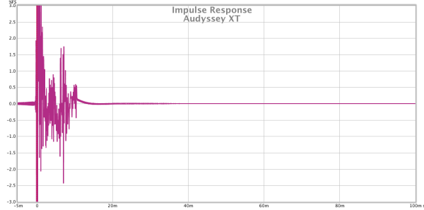

Hmm.. you should know this Remember the flavors - 512x, 128x, 16x, 2x... The length of XT satellite filter kernel is around 11ms - it is clearly visible here:
This effectively means resolution (and also the lowest corrected frequency) is 1/0.011 ~ 90Hz... This is why Chris always recommended to raise crossovers to at least 80Hz for Audyssey flavors up to XT...
IgorZep is offline
This is interesting Igor (and I had forgotten the graphs in the Addendum!) - so when Chris K states:
"It is MultEQ that is in charge of creating the filters and it will look all the way down to 10 Hz. If it finds usable response down there then it will apply correction down to 10 Hz."
(Original is here)
... what is your interpretation of that? Is he wrong? (It wouldn't be the first time he has (inadvertently) made incorrect statements about how Audyssey works, as we know - usually he says that it's because the AVR manufacturer didn't execute Audyssey as intended).
If we can definitely clarify this, it would be a useful addition to the general Audyssey FAQ.

Well I think it depends on your perspective. Technically, the FIR filter will indeed operate on the entire impulse. So I don't think it's "incorrect" for him to say that MultEQ will try to correct down as far as it detects usable response. The question is how successful it will be at the task, and as we have seen only XT32 has enough resolution to really do any usable correction that low.
Just because XT32 is able to do it MUCH better than the lower level versions of MultEQ doesn't mean it's incorrect to state that those lower versions are trying to do it to.

Well he doesn’t say it tries to correct down to 10Hz - he says it does. " If it finds usable response down there then it will apply correction down to 10 Hz."
Igor says it doesn't, and you are saying it doesn't. I am coming round to thinking that if it looks like a duck, quacks like a duck.....

Obviously he means subwoofer when generalizing flavours of MultEQ. And I remember he was recommending multiple times to set crossovers 80Hz as there is not enough resolution for correcting this range on satellites (although he was using some other less technical words for explaining this). And after XT32 appeared he said that it is not necessary anymore, as now the satellites got the same filter resolution as the sub. If your search-fu is good enough you can find his replies on the topic here and on AskAudyssey...

Let's put this in another way. When you apply a crossover of 80 Hz you need not care about satellites below that point anymore coz all contents are redirected to the sub channel having much higher resolution, i.e. correcting to much lower frequencies than in the satellite channels (expect XT32). The flavor of MultEQ kicks-in above the crossover frequency for satellites where obviously XT32 is the champ, second runner is XT and last is MultEQ.

I remember Chris saying these things, so there is no need to search. I just seem to have forgotten! You are right - only XT32 creates filters down to 10Hz. Thanks for reminding us of this.

This is a very interesting but I think relatively theoretical discussion, if you think about the wavelength of a 10 Hz tone. It is a nice marketing move of Audyssey, but I think, that even if a subwoofer could reproduce a 10 Hz tone with enough power, it would not matter how this sounds because you would best be able to feel it but not to hear the tone.
I can walk about 30 to 40 ft to the back wall of my HT and I can hear much lower and more bass there. This is already way out from my MLP and all other listening positions in my HT. This distance equals to a ~30 Hz wavelength.
Honestly, I don't care about 10 Hz in a normal listening environment, but it is nice, that Audssey can do this. Good to know.

I hear you. My in-room response is more or less flat to 10Hz, but I agree that it is theoretical for most people. The main point of the intervention from Igor was to correct some disinformation (that all Audyssey versions create the same corrections) from getting a grip. Since Chris K himself helped perpetuate that particular myth (see my quote above) then it is easy for these things to become 'the law' and it is good that we have people like Igor here to correct us when we go wrong, IMO.
