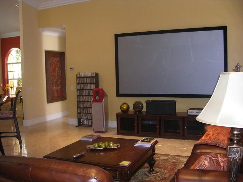

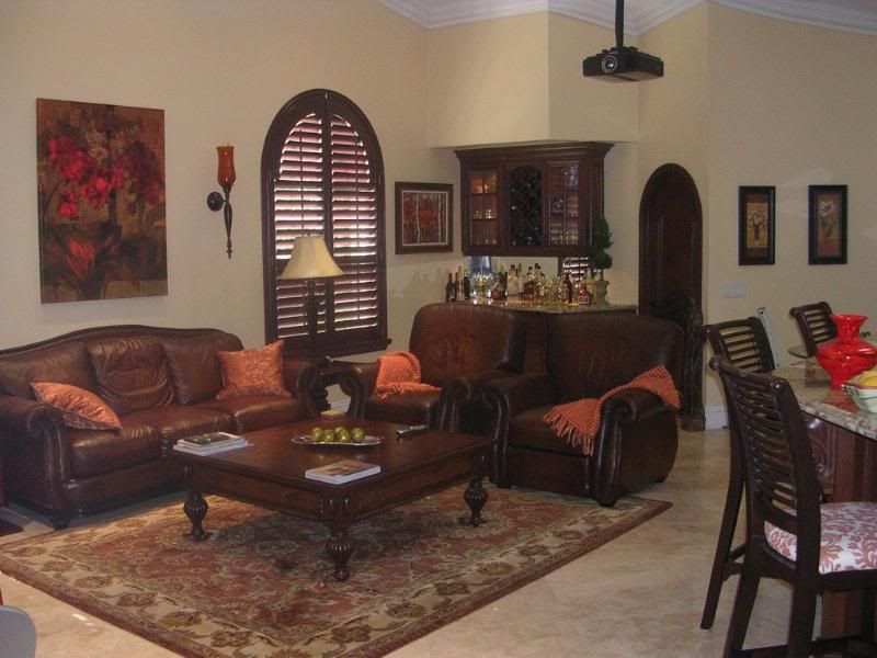

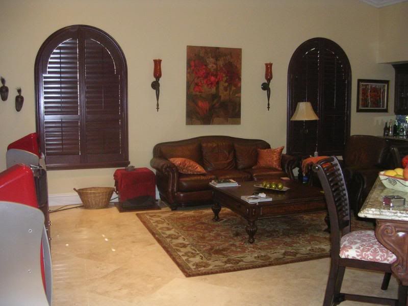

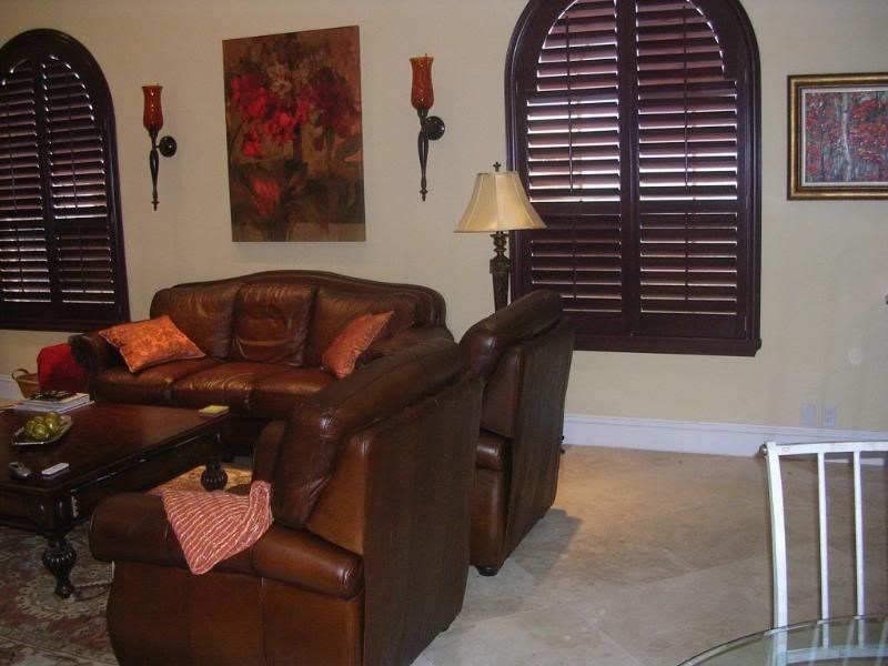

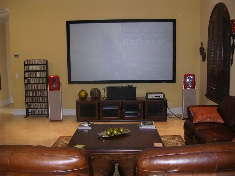

post #1000 of 79637 Old 01-29-2008, 06:40 AM
Heffe156's Avatar
Posts: 128
Originally Posted by Nordo View Post
After running Audyssey it displays "calculating...". This takes several minutes to complete. Then the screen displays a list with "save" at the top, followed by options to review several Audyssey settings including the equalizer settings. You can't change any of these settings here. The option is to review only. NB You must select "Save" if you want to save the Audyssey settings that Audyssey has just set up.
However, if you want to, in your 805 setup menu, you can go to "Speaker Setup"; then "Speaker Settings". Here are listed the equaliser settings (the Xover points) for each speaker. This is where you can manually change them if you wish. In this menu section you can also change some of the other Audyssey settings, eg volume trims for each speaker.
Hello I have the 705 and just ran Audyssey. As you stated above, can I go into the speaker settings, and change the front speakers to small, and will this stay on small or does the amp revert back to the setting that Audyssey calculated. The setting that Audyssey chose was Full Range. My front speakers are 89DB, 40-22Khz.
Heffe156 is offline
post #1001 of 79637 Old 01-29-2008, 08:07 AM
hmcbean's Avatar
Location: Ft Lauderdale, FL
Posts: 101
Originally Posted by audyssey View Post
Since the 705 does not allow individual control of the delay in multiple subs, you have to treat them as "one". My recommendation would be to go out of the 705 to the Behringer and then y-cord out of the Behringer into each sub. I just don't know what line-in to line-out does in the subs...
Then, use the Behringer to do what you need to do for the combined subs. I would not mess with the phase control on the subs.
After that run MultEQ so that it sees the Behringer and accounts for the delay it's introducing.
You could also try a simpler approach without the Behringer and y-cord from the sub out of the 705 to each sub and let MultEQ XT do its thing on the sub. If you can place the subs at approximately equal distance to the main listening position you will be better off.
Chris
Chris, i have a question. I am expecting DHL with my second Revel B15 Sub any minute now, so I will be using my Integra 9.8 with two Revel B15 subs. Unfortunately i can not put both subs equal distance from the main listening area because of the shape of my family room which is "L" shaped. Currently i have one sub on the side wall close to the front wall and was planning on putting the second sub on the same side wall beside the listening position. If i "Y" out of the 9.8 to each sub, and run Audyssey with both subs playing how is Audyssey going to set proper distance with both subs apart? Will I be better off placing the subs together either on the side wall towards the front of the room or on the same side wall beside listening position. I only have these two options for sub placement as there is no other place to put them in my room. I also have Line out on the B15 that i could use. Would I be better off using the line out on the first sub to the second sub instead of a "Y" adapter out of the 9.8?
My room is very difficult to produce bass as it's over 10,000 cf with very high ceilings and rooms that open into others. My family room only has one side wall, the other side is the kitchen. I have attached images so you can see what my room looks like.
Suggestions from others also appreciated. Thanks again.
hmcbean is online now
That is a gorgeous room but all the marble, hardwood, leather and flat wall simply cry out for acoustical treatment. Audyssey will help but I really doubt that all your investment in high-end equipment is giving you an adequate return.
