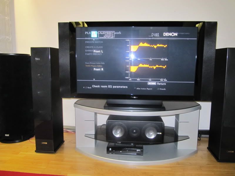

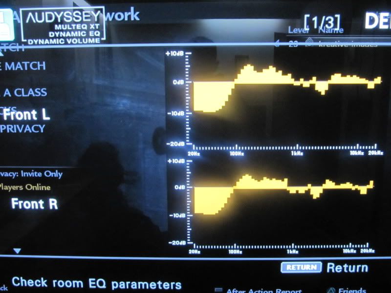

[quote=audyssey;16880057]OSD = On-screen Display. If you go to the Denon Setup menu you will find something called Parameter Check. In it you can check various things including the Audyssey MultEQ filter settings for each channel. These are rather crude graphs, but will give us an idea if there is something strange going on with the filters for your center channel.
Here are the snap shots of the graphs for each speaker, not sure how to read these but let me know if anything looks out of place. Thanks!
Showing speakers and lay out, the graph of the L&R Mains, Center, and lastly the twp rears. The sub is at +3db.
kreativeimages is offline

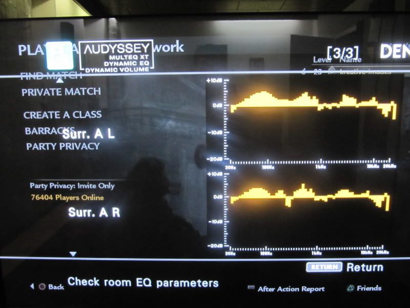

post #16745 of 79637 Old 07-24-2009, 05:15 PM
Mike_WI's Avatar
Location: SE Wisconsin
Posts: 2,816
Quoted: 131 Post(s)
Liked: 79
RE: Audyssey graph pic 3
What is the significance of non-symmetrical graphs (L/R symmetry)?
EG - Audyssey graph pic #3 above
I have also noted that in my room, which while not perfectly symmetrical is close to it when room treatments are taken into account.
(That is, the double door that creates the assymetry on a side wall has absorption panels on it).
Mike

post #16746 of 79637 Old 07-24-2009, 05:20 PM
kreativeimages's Avatar
Join Date: Aug 2008
Location: Ramstein, Germany
Posts: 107
Mike
--I have no room treatments, just some floor rug because we have wooden floors, its an old German House built in 1912, but the size of the room make watching movies fun, plus in Germany we have Rolladens (Metal blinds that roll) so darkness is instant even during the daytime, wish we had these in the States. -Anyhow I also did notice that the graph #3, the graphs look different. Both speakers same height, nothing blocking them, good locations I guess but they are mounted flush to the wall. They were built this way from Canton.
post #16747 of 79637 Old 07-24-2009, 05:22 PM
batpig's Avatar
Location: San Diego
Posts: 28,322
Mentioned: 69 Post(s)
Quoted: 3575 Post(s)
Liked: 3420
is it really surprising that the graphs are non-symmetrical? would you expect the acoustics to be precisely identical in two different positions?
I think it would be much more remarkable if the graphs were identical.
batpig's "Denon-to-English Dictionary"
Setup Guide and FAQ
http://batpigworld.com/
Become a fan "batpigworld.com" on Facebook!
batpig is offline
post #16748 of 79637 Old 07-24-2009, 05:36 PM
Mike_WI's Avatar
Posts: 2,816
Quoted: 131 Post(s)
Liked: 79
I guess it depends if the mic positions were all symmetrically placed.
But if the room, speakers, mics, and any room treatments or furniture is symmetrical, then I would expect the response/adjustment to by L/R-symmetrical.
But I guess that is a lot of IF's that have to all line up.
Mike
HT: Oppo UDP-203 -> Lumagen RadiancePro 4446 {18 GHz input x2 & output x1 cards} - parallel outs to --> [Audio: Denon 5308CI] --> [Video: JVC RS520]
HT Details: link
Mike_WI is online now
post #16749 of 79637 Old 07-24-2009, 05:40 PM
bluesky636's Avatar
Posts: 4,249
Given the resolution of the graph displays, I think they look pretty darn good.
I would be willing to bet that you would see more variation in the frequency response of your ears.
I have never understood why poeple show these graphs and ask if they look Ok to everyone. How do things SOUND to you? That's what this whole business is all about.
bluesky636 is offline
post #16750 of 79637 Old 07-24-2009, 05:48 PM
bluesky636's Avatar
Posts: 4,249
Mike
Add in the fact that the basic frequency response of the speakers would have to be identical. What are the chances of that being true?
Heck, the response in my room probably changes more when my two 80+ lb Golden Retrievers wander in and out of the room than anything else.

Posts: 4,177
Hi, the front L and R look pretty normal but the C speaker does not! Remember, these graphs are showing the correction that the MultEQ filters are trying to do.
If you look at your center speaker filter you will notice that there is a lot of cutting (negative gains) above 2 kHz or so. That will definitely contribute to "muffled" sound in a big way especially since it is over such a large range. But, the low frequency looks odd as well. Normally, one would expect to see a roll off, but we see a boost.
So, I have a couple of theories:
1) the placement near the floor and in the cabinet is severely impacting the low end and adding boominess that will muffle the sound
2) you have a damaged driver (possibly one of the two woofers) and the filter is trying to compensate for it by cutting the highs to "flatten" the response.
You can check the latter by playing low frequency content and gently touching each of the two drivers to see if they are in fact moving.
Chris
Join me for Audyssey Tech Talk on Facebook here.
Follow me @ChrisAudyssey on Twitter here.
audyssey is offline
My humble $.02 worth. The left/right graphs are admirably similar. I share Chris' thoughts about the center. I'm not surprised given the photo of where it lives. The proximity of the above and below shelves will definately make their "contribution" to the sound. The nearby reflective surfaces will have some first reflection effects. And the proximity of the floor will cause any speaker to start to "couple" with the floor (boundary effect). The first reflection off the floor will also be detrimental. Do you have any information on the dispersion characteristics of that center? Many horizontal woofer/tweeter/woofer configurations lobe considerably. The challenge for MultEQxt is significant for the center. If you can improve the acoustic environment of the center, and the speaker is not sick as Chris mentioned, you will see a significant improvement after reaccomplishing the Audyssey calibration. Just my humble opinion.
Cam Man is offline
