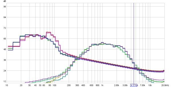

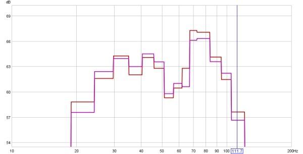

One has to be suspicious in viewing "random" readings in bass level measurements. Is it possible that ambient noise levels could have accounted for fluctuations in measurements? Did you take all the MultEQ OFF readings consecutively, then all the PCM readings, followed by all of the Bitstream measurements? In contrast to first taking the 25 Hz MultEQ OFF reading, then the PCM reading at 25 Hz, then the Bitstream reading at 25 Hz, etc.? Depending on which method you used, if there was say air conditioning noises interfering with measurements, then the measurements might differ more significantly between MultEQ OFF, PCM and Bitstream with the first method versus the second particularly if the noise was consistently present in one situation versus another.
I hesitate to suggest this, but if you were to run your measurements again, and the results remained consistent with your first set of readings, that would help eliminate random fluctuations in ambient noise as a contributing factor in your "random" measurements.
Originally Posted by DR_LaRRY_PEpPeR View Post
I measured each "type" consecutively, not each frequency -- would've been too much switching! But no, I'm confident in the readings and nothing affecting them, and I did it at a high enough level, nearfield, etc. The A/C blower did cycle once that I noticed, but even when it's on, it's a struggle for the SPL meter to stay above 50dB (lowest it goes...).
Hi Matt,
No insult is intended and perhaps I missed your point, but how can you be so confident in the accuracy of your readings, taken with an SPL meter and sine waves, when you admit the air conditioner cycled on during measurements and it had occasional noise levels measured in excess of 50 dB?
Larry

Originally Posted by LarryChanin View Post
Hi Matt,
Please read what I posted again, quoted above.
It's not a mad icon, it's a confused icon, .
Larry
Hi Larry, please look at your post again. (At the very top of your post, next to your name.) I'm not talking about the "text" of your post, but the single icon you can choose for a post. See my Big Grin up there.
Hi Matt,
Larry
Because 50dB isn't going to make a dent in something > 80dB, as there's a 1,000 times difference in power, and 90dB is 10,000x of course. Add 50/60/70dB to 90, and you still have 90dB. Even adding 80+90 would only be about 90.4dB if I'm calculating it correctly...
Here's the meter readings with the different ways. Volume was -32 and meter sitting about a foot away from the sub again. I was using bitstream with MultEQ Off, but of course last night it was the same as PCM. The couple .5 ones are where the meter was going between two... I did a few of the Right Rear channel as well (10dB lower signal, no boost), to show that it's not just the LFE channel (set to 250Hz, Chris). The surrounds are crossed over at 150Hz, BTW. (They were set to 120 last time; both surrounds have a dip that starts there... Just an aside. )
Code:
           --- LFE ---                   --- R Rear ---
        MEQ      MultEQ On              MEQ      MultEQ On
Hz      Off     PCM      BS             Off     PCM      BS
25  |   89       85      94.5
30  |   91.5     90      96
35  |   94       94      98
40  |   96       96     101
45  |   97       91     104             87       81      93
50  |   97       92     103             86       82      93
55  |   97      100     101             87       90      91
60  |   99      104      97             89       94      87
65  |   97       98     101
70  |   98       99     101
75  |   99      101     101
80  |   98       99     100
85  |   97       99     101
90  |   96.5     96     101
95  |   96       95     100
100 |   96       95     100
105 |   96       92     102
110 |   95       89     101
115 |   95       90     101
120 |   96       89     102
See what I mean about the random differences?
I have not carefully checked other speakers to see what happens there, or if it's mainly the sub. The tones on this DVD only go to 120Hz anyway...
I decided to do some measurements to see if I could replicate your issue.
I used DVE SD(DD encoded reference tones) in the PS3 connected vial HDMI to Denon AVR-3808.
Measurements are taken using Laptop running REW(in spectrum analysis mode, 1/6 octave) with Tascam US-144 USB interface(loop calibrated) connected via 3808 line level preamp outputs..........so we're looking at line level output signal not in room measurements.
Trace colours(not quite accurate forum to trace colours)
Red = Sub Multichannel with Audyssey ON
Green = Sub Multichannel with Audyssey OFF
Blue = Sub Bitstream with Audyssey OFF
Magenta = Sub Bitstream with Audyssey ON
Turquoise = Left Surround Bitstream with Audyssey ON
Tan = Left Surround Bitstream with Audyssey OFF
Light Green = Left Surround Multichannel with Audyssey OFF
Purple = Left Surround Multichannel with Audyssey ON
To start with this graph contains all 8 measurements
This is Multichannel and Bitstream with Audyssey OFF
This is Multichannel and Bitstream with Audyssey ON
This is a close up with the vertical scale grid at 3db intervals of the Sub output Multichannel and Bitstream with Audyssey ON
Short story, my measurements show no real differences between Multichannel and Bitstream with Audyssey off or on, so it's not something that affects all Audyssey devices.
Have you made sure that all the different Dynamic Range Compression types are turned off on both the player and AVR?
There are a few and it's not hard to miss one..........the PS3 has one, AVR has Night Mode and DRC or D.COMP(depending on the format which only shows up when bitstreaming).
cheers
