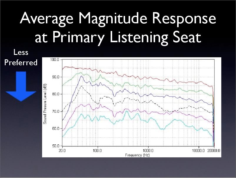

Originally Posted by umr View Post
That is not the 222M variant I am using. I target flat from 30Hz to 2kHz and down linearly from 2kHz to 20kHz to -6bd at 20kHz and to client preference from 20Hz to 30Hz depending on system capabilty and typical volume level. This is then fine tuned by ear with various source material.
I typically shoot for +6 to +8dB at 30Hz, with a linear slope down to 100Hz, flat through the midrange and the same target you use for HF. I find that flat bass sounds anemic. At one time I thought this may be do to listening at lower than reference level, but even close to reference, I still find that +6dB gives the most balanced sound.
As it turns out, the target I've chosen by ear, is pretty much identical to the target chosen by Harman for their JBL Synthesis system (thanks to Roger D. pointing this out).
See page 25 of the JBL Synthesis EQ manual for a visual of the curve:
http://manuals.harman.com/JBL/HOM/Ow.../SDEC%20OM.pdf
Sean Olive of Harman also claims that in blind listening tests of various auto-EQ's, bass lift in the target is preferred.
Can you elaborate on why you find flat response from 30Hz to 2KHz is desirable. I admit that I have very limited knowledge of the science behind the SMPTE-222M curve.
Base in music and dialog is exagerted if you target elevated levels above 30Hz in bass range with accurate gear.
That has not been my experience with my own in-room measures and EQ. And at least according to some trusted sources, a gradual elevation in bass level is needed to provide a sound that is perceived to be balanced.
In the Sean Olive "The Subjective and Objective Evaluation of Room Correction Products" I referred to in my last post, he found this:
And this:
Full test results here:
https://docs.google.com/fileview?id=...ZTUxMGQ4&hl=en
Similarly, on page 25 of the JBL Synthesis EQ manual they talk about the need for LF boost in the target because it is accounted for in during the recording process:
"Room boundaries (walls, ceiling and floor) tend to contain low-frequency energy within the room. Simply stated, this results in a boost in low-frequency energy. This is true whether it is a speaker or a piano producing the sound. The exact frequency at which this effect begins and the amount of boost realized are a function of the room size, shape and wall construction. No two spaces are ever exactly alike. This same low-frequency enhancement also occurs in recording studios, and the recording engineers know this will occur during playback. They balance their recordings in anticipation of this. Therefore, it would be wrong to flatten the speaker system response in the playback environment. To do so only results in a thin bass sound.
By surveying many listening rooms over the years, JBL engineers have established a low-frequency response characteristic that delivers the most consistently satisfactory results. This has been confirmed through extensive subjective evaluation tests."
This is the target they are referring to:
"The Synthesis target curves are derived from data collected in many typical installations. They represent a trend of what should be expected, not a specific shape that must be achieved for good sound."
Audyssey uses a target curve that is supposedly flat from 4KHz down to 20Hz, but I think even they may have changed their target recently based on my own measured results of the EQ's response and the posting of several others over on Hometheatershack.com.

A totally flat response could be perceived has being too bass shy and too treble aggressive.
Yes, this is both what I've read and the reality of things in my personal experience with system tuning.
I agree with UMR though that the more accurate the equipment the less compensation that needs to be made so each case may vary.
While you both make reference to "accurate gear" I believe you two are saying completely different things.
UMR said, "Bass in music and dialog is exaggerated if you target elevated levels above 30Hz in bass range with accurate gear."
If you take accurate speakers with flat anechoic response and place them in a room, due to LF room gain, you will end up with an in-room response that follows the general trend of the JBL target curve I referenced (more or less depending on the specific dimensions of the room). So with a target curve that has elevated bass, I agree that it should take less EQ work to get an accurate speaker to meet the target. Whereas UMR is saying that his target is to remove the room gain (flat response from 30Hz to 2Kz), which will require more aggressive use of EQ to reach the target in most rooms.
In my experience the most natural response can only be achieved with conventional room treatments for the mid-band and up. Since the first four octaves (usually below 250Hz) are much harder to tame conventionally I find DSP duties limited to these frequencies to be the best overall approach.
