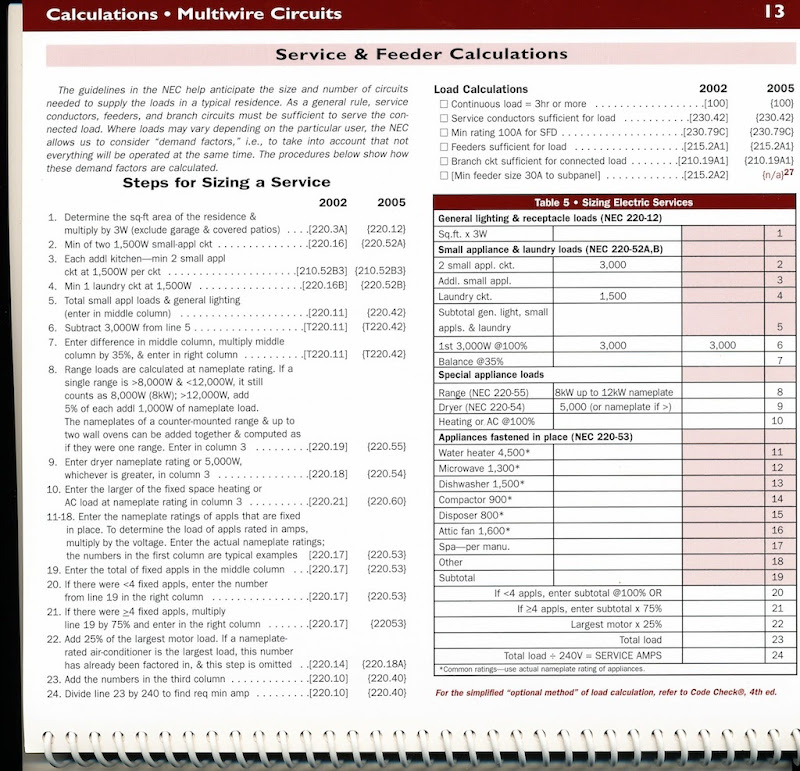

FOH,
Back in 2007 when I was wiring my basement and doing load calculations, I followed this code check book
and this load analysis method per NEC, which includes using the actual nameplate ratings as the "worst case" for major appliances.
Hence I assumed the same for all elect nameplate ratings when doing my HT load calculations.
I've asked DENON exactly that on their facebook wall.
http://www.facebook.com/denonusa
Q related to my home theatre and circuit load calculation. from my Denon 4308CI manual, (140w/ch 7 ch): Power supply: AC 120 V, 60 Hz
Power consumption: 8.1 A. I therefore use 8.1 amps for the "nameplate" amp rating of this @ 120v, correct? (ie, It won't draw more than 8.1 amps from the circuit.)
with this follow-up Q:
follow-up Q. For the nameplate label, is their a std for manuf to follow when stating that information, so for consumers it's all apples-apples when adding up the amp loads?
I'll post their reply here.
[edit]
what the heck, I posted similar Q on the Behringer facebook page also
http://www.facebook.com/BEHRINGER
Q related to my home theater and circuit load calculation. my EP2500 nameplate shows Power consumption: 9.5 A. at 120v 60 hz. (I'm in USA , 120v 60hz power). Therefore I used 9.5 amps for the max amp rating of this in my load calculations (ie, It won't draw more than 9.5 amps from the circuit.) Please confirm max load draw of this amp. Thx.

FOH,
Back in 2007 when I was wiring my basement and doing load calculations, I followed this code check book.......
.......and this load analysis method per NEC, which includes using the actual nameplate ratings as the "worst case" for major appliances.......
......Hence I assumed the same for all elect nameplate ratings when doing my HT load calculations.......
Mike,
Typical mfrs. nameplate rating for operational voltage, and maximum current draw are dead on accurate. For whatever reason (I'm guessing duty cycle/crest factor, pink noise, etc., blah blah), they don't place the actual max current draw. The manner in which they work, a nominal operational impedance of 8 ohms, "X" amps will be drawn. Then, with subsequent impedance lowering, closer and closer to short circuit, the amperage increases. But, they choose to place the 8 ohm current at clipping on the nameplate. Approximately 9-10 amps is max needed when an EP2500/4000 hits max power, at clipping onset, at an eight ohm stereo load. But this is sustained, wide-band low frequency content. typical to program material, not very. But, as I pointed out in the post above, some of the big LF effects are wide-band, and sustained, so one must be mindful of this scenario.
That said, Arny is right. Typically, your amps aren't pulling much for very long. Smaller breakers would generally suffice, but my personal caveat is voltage drop. Even though a breaker will pass huge amounts of "audio" type current, physics isn't short cutted when it comes to the properties of Ohm's Law. The copper, or aluminum (I certainly hope not) that resides between your LF amplifiers and your panel-board, needs to be sized so that voltage drop is not a concern. Rarely is a potential choke-point so easily addressed, and put to bed, as is the case with up-sizing of the branch circuits feeding your amplifiers, LF or otherwise.

Originally Posted by KJSmitty View Post
How about doing it the right way and adding up the total "watts" required to run the equipment? You most likely have 120 volt service on a 15 amp breaker. That equates to a total safe load of 1800 watts on that breaker. One must remember there is very likely other items, lights and plugins on the single breaker as well that could draw watts at the same time your AVR/equipment is in operation.
Each of your components will list the "watts" usage for each. Just add it up. Now, the other side of it is the referenced wattage numbers are typically max draw and you will typically never see that max load thus just because you total them all up and it exceeds say 1800 isn't a show stopper. I would suggest a power center that tells you current amp draw. That way you can tell the exact amount of power you are pulling on your circuit. IE: if it displays a draw of 5 amps that would be a total of 5 x 120 = 600 watts thus we'll within your say 1800 limit.
Cheers
^^^ I like this answer. I want to add a comment....lots of people out there are confused about the word "watts", especially when talking about power consumption. Example: my five channel separate power amplifier's manual says power consumption 1400 watts. The output however is 150 watts x 5 channel RMS.
