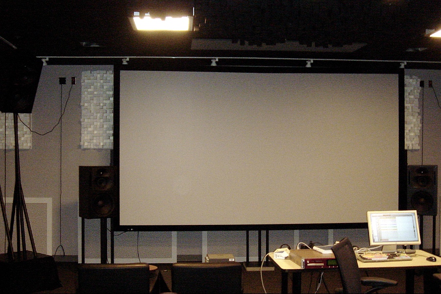

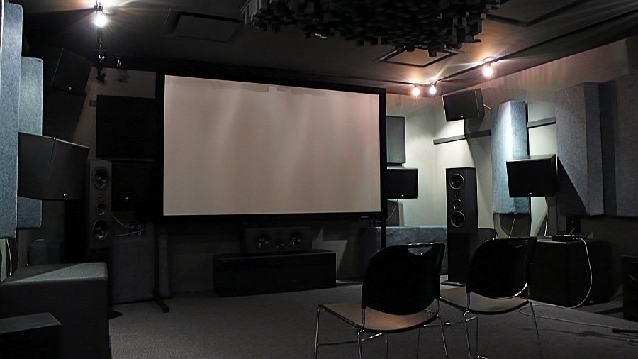

post #54 of 594 Old 04-03-2012, 02:39 AM - Thread Starter
Skylinestar's Avatar
Location: Borneo Island
Posts: 2,463
Quoted: 920 Post(s)
Liked: 153
Originally Posted by localhost127 View Post
to the OP,
additionally, if you want to maintain symmetry, you would not apply treatment to one side of the room and not the other
Does that mean sidewall absorbers on left & right walls are not required as it's now in symmetry?
According to the audioholics DSX education page here...
2) Width is more important than height!
Width is crucially important in placing instruments and recreating acoustical space. Concert halls with side walls perpendicular to the stage are considered by experts on the subject to be acoustically superior spaces to fan shaped halls. One of the reasons here is the importance of the early reflections from the right and left side walls perpendicular to the stage. In the "fan shaped" concert halls, the splayed side walls did not support the same kind of early reflections and are one of the main reasons these halls are not judged as good by the experts. To quote Mr Holman, "it is known in concert hall acoustics that the first side wall reflection is the single most important reflection direction, it sets the auditory source width... Channels constrained to plus/minus 30 degrees are too narrow for that". For this reason, the DSX standards (7.1, 9.1 and 10.2) support a left wide and right wide channel at plus/minus 60 degrees to reproduce the kind of side wall reflection you would hear if you were seated in a great concert hall. (Note: Those who recall Audioholics' original article on 10.2 may note that the front widths were at 55 degrees, not 60 degrees. According to professor Chris, this small adjustment was made because the difference between the two angles was minimally audible, and "60 degrees is easier to eyeball").
... the early reflections seems to be a good thing if applied properly.
Since I am having a DSX Wide sound stage setup for movies, is there any need to reduce this early reflections in my room using absorber? IMO, it will be a good thing because it's best to kill off this nasty haphazard early reflections using absorbers & replace it with the desirable sound that is created by the DSX Wide channels. Am I correct?
From the photo above (Audyssey's Surround Sound Room), looks like there are absorbers next to the speakers.
Skyline diffusers on front wall?
Skylinestar is offline

You seem to be confusing building a concert hall with building a listening room.
The two tasks are very different. I hope you have noticed the obvious difference in size! ;-)
Do you want to localize where your speakers are, or do you want to localize where the instruments were in the concert hall?
and the fundamental behavior of the acoustical energy is different - as in a Small Acoustical Space (SAS) where what reverberant sound-field exists is above our hearing range and below the ambient noise floor (thus, no appreciable reverberation exists - but we do have specular 'room decay'), we deal with sparse reflections bouncing around the room like laser beams of which the reflection's magnitude, time-arrival, and vector components can be determined (eg, virtual images) --- and thus, destructive interference with respect to intelligibility, localization, and imaging with respect to the direct signal. you can take measurements from differing points within the room and notice the great discrepancies in response from one point to another as the energy is not "well-mixed".
in a Large Acoustical Space (LAS) such as a concert hall - with the development of a statistically homogenous reverberant sound-field (at frequencies based on volume calculation from Dr. Schroeder's FsubL equation), the energy is equal and probable in any and all directions. you cannot determine magnitude and vector components of the indirect energy as it is "well-mixed". you also have the constraint of being past the critical-distance, of which the reverberation is higher in gain than the direct signal. but you will not find a critical-distance within a Small Acoustical Space like our residential rooms.
this is why we must continue to encourage users NOT to emulate the 'treatments' they see in a LAS or movie theater to that of a SAS like their residential home theater.
dragonfyr's/mas' commentary here is a worthy read if you are interested further: http://www.hometheatershack.com/foru...rt60s-sas.html
and: http://www.avsforum.com/avs-vb/showp...postcount=8563
Originally Posted by dragonfyr View Post
To reduce the distinction to its most basic functional charactrisitc, a large acoustical space features a developed statistically random reverberant sound field where reflections at any location are equally probable to radiate from any direction. Conversely, a small acoustical space LACKS a statistically random reverberant sound field where reflections at any location are equally probable to radiate from any direction – and instead is DOMINATED by focused specular reflections which are definitely identifiable as discreet phenomena as energy vectors with both direction, intensity and a discreet time of arrival, while their intensity decay and their distribution in regards to their arrival time can be measured and all of these characteristics easily identified and isolated via such measurements as the envelope time curve (ETC).
localhost127 is offline
