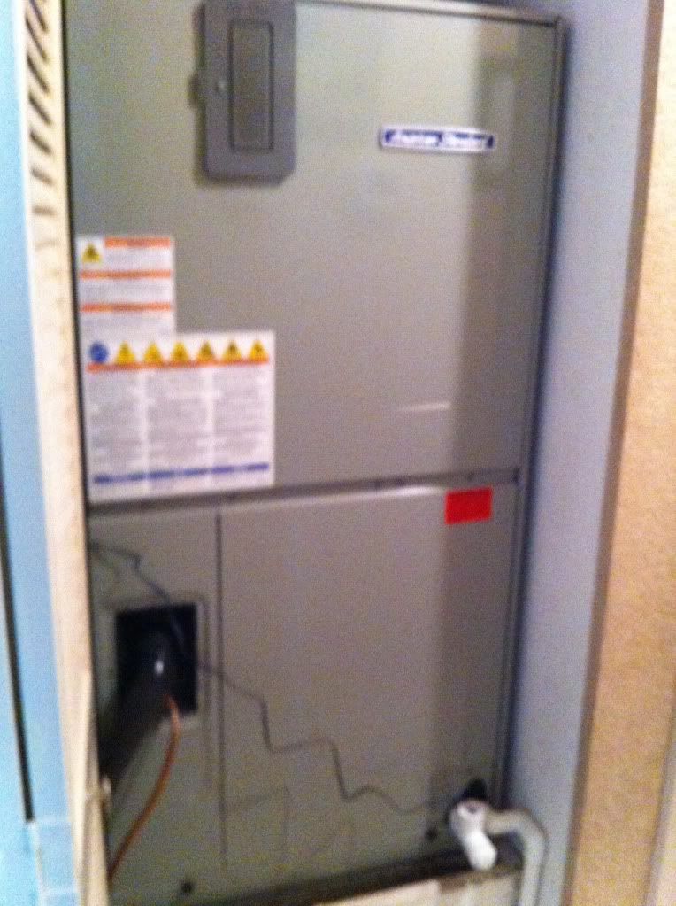

post #7 of 23 Old 04-20-2012, 01:38 PM - Thread Starter
ratm's Avatar
Posts: 1,616
Quoted: 36 Post(s)
Liked: 36
I added some pics:
Here is the handler itself:
Here is the intake of the handler. Its underneath the handler itself and there is about 15 inches of clearance here:
Here is the door:
My thought process was to place the foam on the inside of the louver, from about 2 feet off the floor to the top. Am I wasting my time? The foam and spray tack wouldnt cost me more than about 25 bucks.

post #8 of 23 Old 04-20-2012, 02:16 PM
bigbare's Avatar
Posts: 735
I dare say to fix the problem will take more than some foam on the doors. It almost looks like the unit is starving for air. What kind of noise are you getting from it. With out knowing the size of the unit it seems like a 15" opening at the bottom isn't big enough. Maybe in an open room you'd be ok but not stuffed in a closet like that.

post #9 of 23 Old 04-20-2012, 06:35 PM - Thread Starter
ratm's Avatar
Posts: 1,616
Quoted: 36 Post(s)
Liked: 36
Its a 4 ton unit. And thats the only place its ever been.
