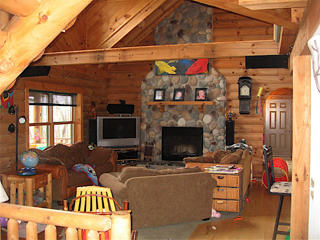

I was looking into THX Select2 and Ultra2 gear for my living room, which is big open floor plan. The TV is going to be over the fireplace at the red oval. LCR speakers are going near the TV; surround LR will be ceiling mounted above the 2-seater couch. There is a drop floor in the living room area which creates an approx 9.5' ceiling; everywhere else it's approx 9'.
When approaching THX gear, how should I account for my space? Should it be a room the size of my living area? E.g. 15.5' × 16.3' × 9.5' = 2400 square feet. Or include the kitchenette/kitchen area? E.g. 2400 s.f. + approx 2150 s.f. = 4550 s.f.
I'd like to hear TV/music clearly while eating in the kitchenette or working in the kitchen. I don't expect it to be "surround sound" outside of the living room sitting area. Basically, should I go for Select2 for living area and add background speakers to the kitchen ceiling, or lean towards a Ultra2 setup instead? This is affecting how much I really need to spend on gear and how big of speakers do I need to install.
Any thoughts?
I'm assuming I wouldn't include the dining/entrance area in the calculation since I don't primarily intend to listen to main TV/music there, but it is open area that has to affect sound somehow. Does the lack of "left" wall space negatively affect the sounds in living room?

I'll spend up to $4,000 total for speakers and a new AVR/amp. At a minimum I need a 5.1 system; if it's reasonable to do so and meets WAF I'll do 5.2.
Some constraints:
  • The ceiling LR surrounds have to be fully enclosed due to living space above. The large ceiling joist spaces will fit about anything.
  • LCRs can be in-wall or on-wall. LR can also be bookshelf. Can't do in-ceiling LCR due to a large ceiling fan.
  • Exterior walls are standard 4" and insulated.
vivatech is offline

Can the LCR approach encompass any style? Small bookshelf, larger bookshelf, etc? I'm thinking three identical 8" two ways across the front. Sub, TBD, the surrounds, do they need to be in-ceiling?
Your $4k is for sub(s), and sub(s) amplification, LCRs, surrounds, and AVR or Pre/Pro, correct?
Yes, up to $4k is what I'd like to spend for speakers, subs & amps, and AVR or Pre/Pro.
Below is a picture of the application (perspective view of OP picture). I'd like to get a shelf of some sorts between the fireplace and TV for a Xbox Kinect sensor, which is not shown.
Surrounds need to be in-ceiling. Pedestal speakers are not an option due to my kitchenette furniture and routy kids.
With the TV over the fireplace I'm limited in center channel solutions so I've conceded to an in-wall or on-wall solution. I've toyed with building a center channel in-wall speaker into a simple mantle. The TV is not mounted yet so I have some flexibility with the height. Actually I'm having issues with my TV so I might wind up getting a new one.
The LR can be bookshelves sitting on the floating wall cabinets and alternatively there's a pretty big wall to install in-walls or on-walls. The floating cabinets haven't been built yet either so there's some flexibility there, too.

Before we get to specific recommendations, are you sure you want to pursue an above the fireplace set up?
I don't intend to offend, please don't take offense but this type of an approach really sucks for enjoyment of video. the only aspect that it's well suited for is for static appearance, magazine ad style,..that's it.
Also, immediately upon seeing your layout I see the un-balanced audio environments on the left and the right. The left is open, the right is boundary adjacent. This is problematic from the start and can't be overcome. Yes, many set their systems up this way, and everyone of them possess this problem. Is it at all possible to place the display at proper eye level, and in the corner, firing directly across the space. That way the acoustic environments are uniform left and right. You can corner load the subwoofer behind the display, and have your primary LP in the area between the two columns.
This is the way I'd set up the room.
Is this possible for you?

Yes, I'm definitely sure about the over-the-fireplace location. Long deliberations have taken place over that topic and there's no going back. smile.gif
It came down to looking slightly up (15° from the couch to top of TV) and having slightly poor acoustics vs. having zero straight-on view of TV and requiring left/right head tilts, blocking the window, requiring the curtains to be always drawn due to south-facing sun, not having a clear shot to the kitchen. The fireplace wins in my current house and my next house will not have one to avoid this situation altogether!
This was my comparison:

I understand, and i hate to even contemplate "re-engineering the wheel" as it were. However, it's not just the viewing angle, and slightly worse acoustics. The asymmetry can't be overcome properly, so I'd be remiss if I didn't point it out. All said, I fully understand your quandary. The right image isn't acceptable to me either, I intended to have a primary listening/viewing position in between the columns.
But no prob moving forward with the fireplace wall approach.

Well... for argument's sake, where would you place the speakers if it were like you suggested?

What FOH mentioned for corner placement vs over the fireplace is what I did for my family room 5.1 set-up, see below
(in my case I was forced to place the RH speaker far on the other side of the fireplace, not the optimal but it works
I have a solution planned just "life" with 4 kids keeps getting in the way, http://www.avsforum.com/t/1391600/possible-to-make-new-cabinets-for-my-at350s-drivers-for-placement-issues ..)
However, since you want in wall speakers this layout may not work for you since you'd be hard pressed to place them firing towards your MLP zone.
My friend just did exactly what you did, TV above fireplace, and we were there for big labor day party.
sitting on the couch I did get a little neckstain, but I'm 50 and all that so maybe for younger folks no problem.
Your sub, for $1k I'd go internet direct, or heck a basic DIY solution for $1k would kick butt over anything else!
Post in the DIY sub forum, the gang there will take care of you, http://www.avsforum.com/f/155/diy-speakers-and-subs.
btw, Atlantic Technology is a great company, I'm using their old AT System 350 in my family room set-up and love them.
Back then, circia 1996 design, they were rated THX Ultra, then they started getting into the "good-better-best" marketing thing and came up with "select-Select2-Ultra2".....http://en.wikipedia.org/wiki/THX#Certifications

I was reading the Atlantic Technology specs and they stated to keep the speakers within 18" of each other vertically to ensure a flowing front stage.
Not sure how they measure 18" but I have more than a few choices. What's the best location for the speakers- closer to a vertical line or more even with the TV?
Also, I went with 10' outside edge horizontal separation. Is that the maximum I should go?
Higher:
Lower:
vivatech is offline

The measurement is from tweeter center to tweeter center. Ideally all 3 tweeters should be at the same height, but an 18" offset of the CC is acceptable.
I prefer a vertical line for the speakers instead of surrounding the TV. Personally, I would go with an above-TV placement rather than below. If going above the TV, aim them down at the listeners ears.
The recommended angle is 22 to 30 degrees. A 10' spread at 16' listening distance is about 17 degrees, so it is not wide enough. However, these are just guidelines and I prefer a placement that is "scaled" to the size of the video display rather than to the listening angles. IOW, although it's not within the guidelines, IMO, it should be fine. The right sided chair and the left sided sofa will not be good seats for audio.

Thanks for the suggestions, Craig!! I like the new setup.
If I place the center channel above the TV and aim down, I'll have to go back to the Klipsch KL-7800-THX series. There would be too much customization and too many calculations recreating the Atlantic Technology's IN-BOX-155 speaker box.
Actually, placing the center channel KL-7800-THX in it's own speaker box works out quite well. If I had installed it in the wall I would have to have done some significant reframing since the 20" cutout doesn't fit within a standard 16" joist when oriented horizontal. With the speaker box, the center 7800 doesn't require any reframing. Plus, I was generally fearing installing the AT speaker boxes in old construction! I preferred the fully enclosed Klipsch THX series for their easier installation.
I called Klipsch yesterday and they said the above-the-TV center setup would work fine. They also said that with the center channel aimed towards the LP I could space the tweeters more than 18" apart. The 18" would be more if the speakers were firing on the same plane. Klipsch also recommended using two SW-110 for LFE.
In the photos the center speaker box front is angled 15° down to the LP. The speaker box will be 1/2" MDF.
