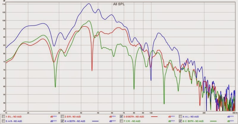

I ran a few measurements over the past few days to find the best location for my dual subs. Due to WAF concerns and the odd shape of our room, I only had 3 options which are named A, B, and C on the following graphs. Audyssey was not used during these measurements. https://dl.dropboxusercontent.com/u/...0no%20aud.mdat
Here is a capture from that test showing both subs and no audyssey: Location A is blue, B is red, and C is green. Since the location A (blue) had fewer nulls, I figured it was best.

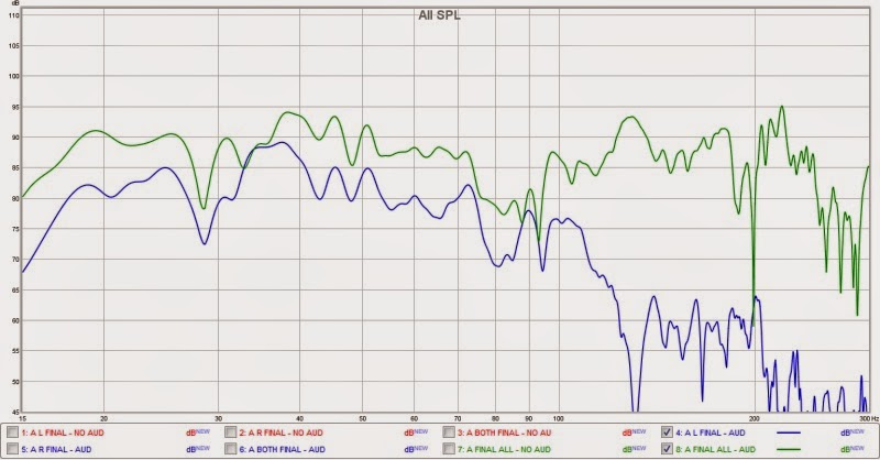

After that, I level matched and ran audyssey to get the following graphs. This measurement also included mains. https://dl.dropboxusercontent.com/u/...A%20Final.mdat
This capture shows both subs with audyssey in blue. Green = both subs and mains with audyssey.
Good? Bad? Thoughts? Ideas for improvements that doesn't include moving the subs? These graphs are much better in comparison to the graphs I posted last week which showed the FR with the subs inside the built in cabinets.
I didn't pay too much attention to the waterfall graphs at this point. I will be replacing these subs with a different set and then running EQ through Mini DSP once I get the new subs up and running. Will different subs in the same locations create much different results? I assume the nulls will not disappear.
Zee-man is offline
I would have picked the red trace in the first graph. Just my $.02
I agree, less peaks for Audyssey to pull down = less distortion + more headroom.
UNLESS, location B doesn't give you enough headroom, then you may be forced to use location A.
Also, the scale is wrong on your graphs. Should be 45-105 on the vertical and 15-200 on the horizontal.
Oh, and really no need to measure so loudly. You could pull down the MV 5 or 10db and still be fine.
Alan P is offline
In this graph, the green trace is looking pretty good. It gets a little hinky around 80hz. I'm assuming your crossover is at 80hz...? If so, you need to do the "distance tweak".
Change your sub distance setting in the AVR up and down a foot at a time and see if you can't get rid of that dip at the crossover. Do this with both subs and FL/R playing. Measure at 1 foot increments at least a few feet in each direction and you should see a vast improvement in that 80hz dip.

Your MDAT file doesn't have any of the Audyssey ON measurements.
