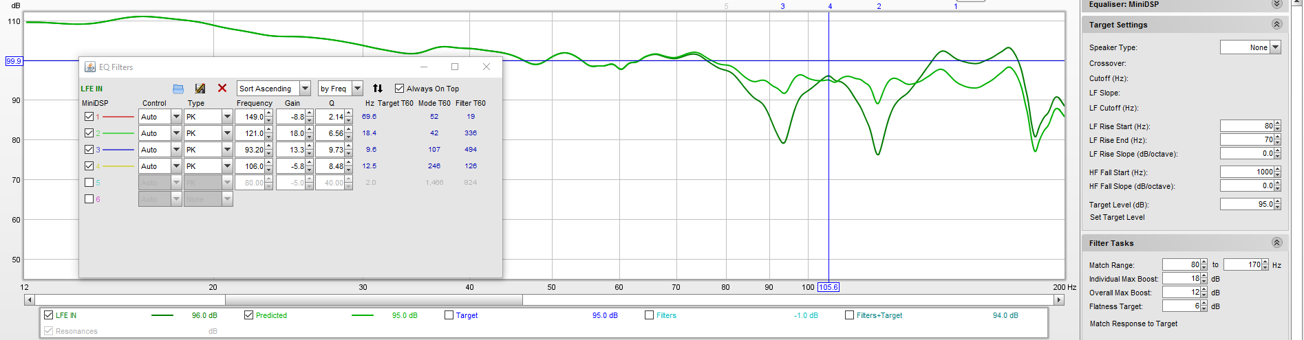

Hello,
is it bad to boost the upper frequency's or dips in the HF range? i was curious to try something but i haven't gone pass EQ in the software yet, i wanted to know before i test it on the sub.
A boost is one thing; an 18dB BOOST is not a good idea.
You're probably trying to fight a null, which is a loosing battle. Try moving the speakers around a little.
Michael
its the sub and that the best placement for it unfortunately, i might as well leave it alone if its a null.
Hello,
Those dips look very similar to ones I had in the bass and upper bass regions.
In the bass region they are due to subwoofer location so moving the sub around helped.
In the upper bass they were SBIR so moving the speakers closer to the wall and letting my room EQ deal with it has worked best so far. I could not put them out farther from the wall than they were.
Set individual max boost to say... +3dB. Also, your nulls are at 93 and about 110 Hz and you will most likely use crossover between 60 and 80 Hz like most people...unless for some reason you need to cross it higher. If your crossover happens to be at 80 that 93 Hz dip might still show up on your overall response, so I suggest you try adjusting crossover slope if possible (-12 or -24dB) and measure to see which setting gives better overall response.
