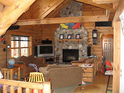

Well - I have almost same situtation, and even started a thread on "fixing" it.
Due to busy with "life" othert still listening with speaker off centered to TV....and I'm ok with that for family room usage.
http://www.avsforum.com/t/1391600/possible-to-make-new-cabinets-for-my-at350s-drivers-for-placement-issues
Background:
I Bought my Atlantic Technology 5.1 Sys 350 in 2000 for my "old home" family room HT, it worked well there. These are circa around 1996 design...
When we moved into the new home May-2002, their placement was compromised due to corner location, fireplace stonework, etc.
I accepted it.
You can see here, the RH is way on the other side of the 2005 42" HDTV.
(main HT is basement, so this is 5.1 for casual watching/general sound for parties/etc)
That "old" 2005 HDTV, 42", is a space hog - width/height and depth (14" slim), I've done some measurements and appears 45-47" thin surround bezel HDTV could fit into it place, AND I could put the RH/LH in their "proper" location next to the image...here's the catch.
I would need speakers with less depth to make it all work.
Options:
a) Buy new/used thinner RH/LH mains, hopefully tonal match close to existing Center and surrounds, current/recent Atlantic Technology 's
b) Use existing drivers/crossover, make new cabinets thinner/taller.
Key is I angled the R/L and Center toward a MLP, ran audyssey to set distance/levels, and it sounds decent.
Good luck, not everything can be perfect/ideal, some compromises are needed.
