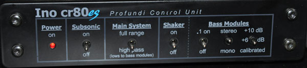

Well, as it stands today there's a Panasonic BluRay and a Pioneer 668 dvd-player and a Sonos for sources, I have a Denon 2807 and a Krell Showcase to choose from as processors, but I hope to go to a Denon 4520 or similar later on. An Oppo BluRay would be nice too.
The front speakers will be powered by a Rotel 1090, the subwoofers by a NAD208 and there's a Marantz MM9000 to power other channels. So a little short on channels for the Showcase.
Fronts and subs will be electrically crossovered by an Ino cr80es filter rather than in the receiver, it's got better slopes for that and it sums fullrange front signals with the .1 if one can't trust the receiver to do that properly. It's got a infrasonic boost card in it so I can shape the bass lift both in curve shape, amplitude and Q at crossover point, so that will handle a big part of the hourse curving.
Here's how the beauty looks like, quite useful functionality on it:
Speakers are almost all Ino Audio speakers. Fronts i32s, subwoofers infraY, surrounds ambience2, ceiling surrounds ambience1. For front wide I plan to try Carlsson OA52 and for front high Carlsson OA51.
No center yet, but I hope to find an Ino i16s or even a single i32s more. A good amp choice to find for that could be a Rotel 1080/991 and bridge it externally.
