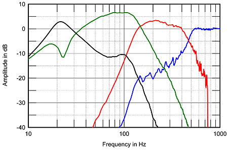

Here is a personal example: Revel Salon2: http://www.revelspeakers.com/products/details/42#specs
Frequency Response - 3 dB from 23 Hz to 45 kHz ±0.5 dB from 29 Hz to 18 kHz ±1.0 dB from 26 Hz to 20 kHz
Low Frequency Extension -10 dB at 17 Hz -6 dB at 20 Hz -3 dB at 23 Hz
Here is the measured response of each driver by stereophile: http://www.stereophile.com/content/revel-ultima-salon2-loudspeaker-measurements
Fig.3 Revel Ultima Salon2, nearfield responses of port (black), woofers (green), lower-midrange unit (red), and upper midrange unit (blue), all plotted in the ratios of the square roots of their radiating areas.
As you see, it goes pretty low. I tested our Salon2 with three amps: 250, 300 and 400 watts. In a large room, the 400 watt was the only amp that caused my ears to complain before the speaker did smile.gif. With the others, I could notice the bass not keeping up before it reached reference level to my ears. I asked my good friend Kevin Voecks who heads speaker design at harman and he made the same comment.
The reason for such high power requirements is the same as why there is high power requirement in subs. In the past, big speaker boxes were desirable as that showed you that you knew "hifi." Today, people want diminutive speakers that don't stand out. As a result we have much smaller enclosures than in the past which causes the efficiency to go down. So Kiwi is very much right on his comment that if you have proper full range speakers, you need much more power than the "AVR spec" that gets thrown around as being sufficient for every need including solving hunger problem in Africa. smile.gif
amirm is offline
Lots of things go low, but how cleanly they do that is of the essence. I see no measurements of nonlinear distortion so for all I know these puppies are doubling like there is no tomorrow at levels that a good dedicated subwoofer would take in stride, Potential clean bass goes up with the cube of driver diameter, and that puts the 3 x 8" drivers behind the 8-ball as compared to a single 15" which is what you find in good dedicated subwoofers.

Without knowing the sensitivity of the low frequency drivers can you say that with complete certainty? You are supplying a definitive answer without complete information. Don't get me wrong, if I HAD to guess (and GUESSING is all that I can do given information provided by the manufacturer specs and Stereophile measurements) I would agree with you.
The manufacturer advertises 86.4dB sensitivity, but no frequency range is given. The manufacturer offers no power rating. Stereophile's impedance plot indicates an average 4ohm impedance below the 150Hz crossover.
Assuming a peak reference level 105dB is desired and the Revel bass drivers' sensitivity 86dB 1 watt; using my crude calculations: about 600 watts peak in an anechoic environment is needed to achieve the desired room SPL with a seating distance nine feet from the speaker. In a non-anechoic environment, about half the power, 300 watts, would be sufficient.
Will the Revel speaker handle 300 watts without driver compression? Probably. Can a 100 watt amp peak at 300 watts? Probably not. But lets go back to the central point of the discussion:

Originally Posted by arnyk View Post
Besides, its generally agreed that forcibly co-locating the subwoofer with the L&R speakers is suboptimal in most cases.
And BTW did you notice the design aspect of these particular speakers...
Placing a sub driver top and bottom also helps overcome room nodes. Many people place multiple subs around a room but usually end up placing them all on the floor and forget about the vertical plane. Placing some subs low and some subs high is just as effective. (I use four subs in my room with one of the subs placed high up near the ceiling)
If I was building my own full range tower speakers I would probably do the same as pictured above. Advantages would be keeping bass stereo and also closer to equal distance from the LP.
kiwi2 is offline
post #594 of 651 Old 04-19-2014, 10:57 PM
A9X-308's Avatar
Location: Australia
Posts: 5,922
Quoted: 428 Post(s)
Liked: 277
The main vertical mode is at half room height, so this arrangement won't really help even if they are actually subs and not midbasses. I'm building 4 of my subs so that they each have one driver at mid wall height and one near the floor.
A vertically symmetrical array has the advantage of controlling vertical dispersion minimising the effect of floor and ceiling reflections as well as doubling the volume displacement of all but the HF drivers.
A9X-308 is offline
