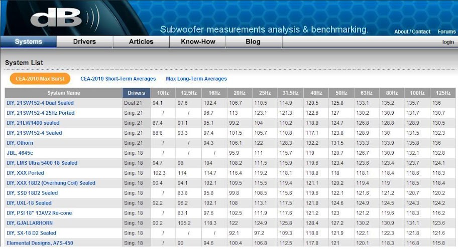

Reason I pointed the OP, Turlen, to data-bass.com is there one can visually see in a nice comparison table the various freq and spl many commercial and DIY subwoofers will obtain, a site by fellow AVS member.
screen snapshot example - many more on the swite:
Of all the sub-woofer threads I've seen on various forums, these 2 on blu-ray.com do a decent job of summarizing many-many discrete info sources.
You've still got to know how to interpret the data.
+1
However, some people seem to want definitive answers even if they can't quantify what they want. And, no serious technical questions or discussion please! ;-)
