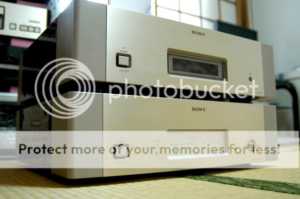

I do know of a couple of products that used dual link optical, both from Sony. It was however a proprietary implementation that separated the clock from the signal (smart thing to do). One is the Sony CDP-R1/DAS-R1 combo:
And the business end showing the cable and connector:
The other is the Sony CDP R10/DAS R10:
And the close up of that:
These are pretty classic products,especially the R1. Were you guys not around when they were announced?

Originally Posted by arnyk View Post
One word: Outsourcing.
Like, the whole project not just the assembly.
Not those machines. This was still the golden years of Japanese audio design/manufacturing. We are talking 1980s. The CDP-R10/DAS-R10 retailed for something like $18,000! They only made a couple of hundred of them for Japanese market. They made a lot more of the CDP-R1/DAC-R1 combo but still very low volume and all designed and manufactured in-house.
I miss 1970s and 1980s HiFi days. We didn't have the emphasis we have today on the cheapest junk that sells. I mean look at the guts of DAS-R10:
See those hybrid Sony modules. Massive power supply. Remember, this is just a DAC, not an amplifier.
Anyway no, outsourcing is the name of the game today, not then. The high-end audio market is still where you find that kind of craftsmanship and in-house design and manufacturing.
I was responding to the other quotes from post #20.
BTW I don't know if those are custom modules or engraved tin roofs over cheap components! ;-)
I checked the Sony audio components out and found that they list priced for about 2 million yen each. I don't know if the exchange rate was 100 or 140 in those days but we're talking $15-20K each. Allegedly about 200 each were made.
What a waste! Obviously for show not added go as Sony's standard consumer product of the day fully exploited everything audible that 16 bits and 44,100 Hz sampling could do.
Two words: Anti Engineering
But as artistic sculpture? Very limited market. I wonder what their estimated auction value would be appraised at on Antiques Roadshow, Pawnstars, or American Pickers. ;-)
