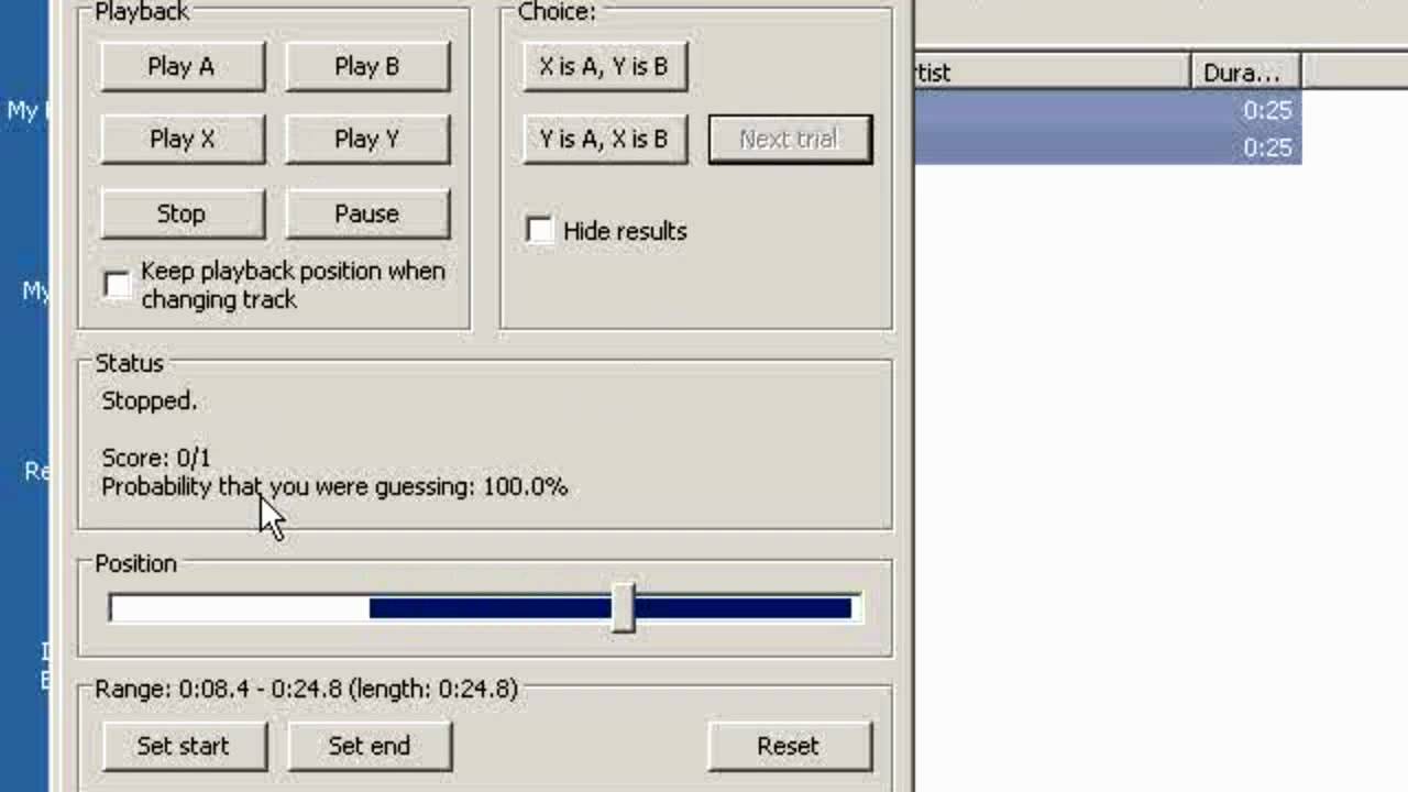

Originally Posted by Frank Derks View Post
As usual Amir, you didn't get the point of Arny's latest challenge.
No one said I am that smart .
Originally Posted by frank
All your ABX results are very suspicious because most likely you had lot's of intermodulation distortion in your setup, help from the dogs or hooked up the AP analyzer.
You are giving me way too much credit as I had to deploy all three measures and then some to hear the differences. To be clear, I had two dogs co-listening with me, not just one. I am hoping to borrow a second AP as the tests get harder.
For now, I am at our vacation house with dogs but no AP. I do have a PC connected using HDMI to my Pioneer SC63 AVR driving Revel speakers in a large and highly reverberant living room. This is what I got:
foo_abx 1.3.4 report
foobar2000 v1.3.2
2014/07/22 08:31:52
File A: C:\Users\I5 Media Center 7\Desktop\Arnys Filter Test\keys jangling band resolution limited 4416 2496.wav
File B: C:\Users\I5 Media Center 7\Desktop\Arnys Filter Test\keys jangling band resolution limited 3216 2496.wav
08:31:52 : Test started.
08:32:24 : 00/01 100.0% <--- Confused dogs licking my face for hearing a difference
08:32:49 : 01/02 75.0%
08:33:04 : 01/03 87.5% <--- Bird flew by the window and the dogs found that more interesting than keys jingling
08:33:37 : 02/04 68.8%
08:33:47 : 03/05 50.0%
08:33:56 : 04/06 34.4%
08:34:09 : 05/07 22.7%
08:34:19 : 06/08 14.5%
08:34:32 : 07/09 9.0%
08:34:44 : 08/10 5.5%
08:34:53 : 09/11 3.3%

Average RMS level of Arny's file is -35 db. That is a very quiet track. You don't know what level we all used to listen but if we had turned up the volume, that would be justified given how quiet this is.
Originally Posted by krab
..., and not scrutinizing it on a second-by-second basis to find the 'tell'
Oh? So you would be advocating that the buttons in foobar2000 ABX that let you select a segment be removed?
How about we put our heads in the sand and listen?
