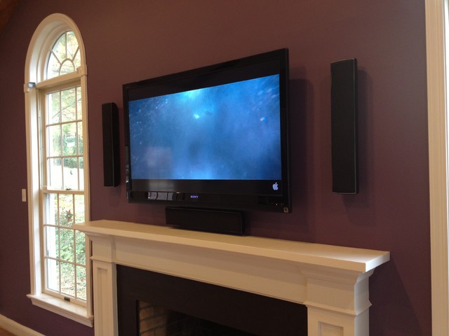

The on-wall LCR's would look something like this:
Also have your builder install surround speaker wires from your equipment location (where the AVR and Blu-ray player are located) to the in-ceiling locations so the surrounds can be installed when complete.
In-wall speakers have quality drivers, but most of them don't have built in enclosures - so the same amount of sound going into the room also goes into the attic or wall which makes the sound "muddy" and vibrates everything so the sound can be heard in adjacent rooms.
If you want in-wall speakers to sound good, you either need in-walls with built-in enclosures (which are expensive) or enclose the space where you are mounting them with standard building materials yourself or have your builder do it.
