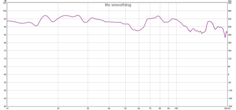

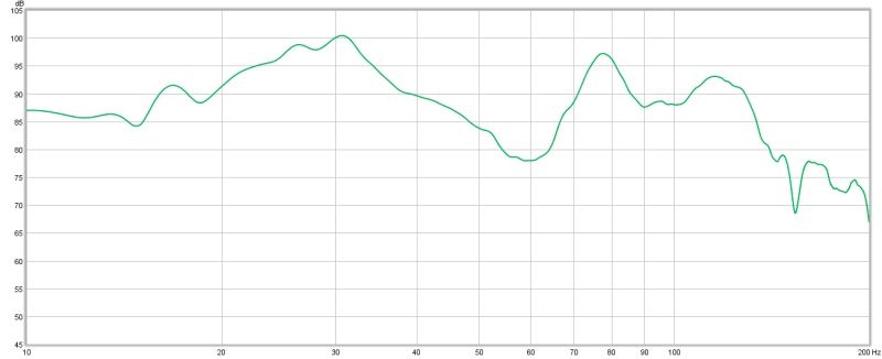

Thinking of getting some GIK Tri-Traps to go in the back of my living room, here:
Think they would do anything at all to my 60hz null?
Same null, post-Audyssey:
Probably not. A null is caused by a reflected wave meeting the original wave 180 degrees out of phase at the point where the null is measured. 180 degrees out of phase is 1/2 wavelength, so there's likely a 1/4 wavelength distance either between the source and a boundary or between the LP and a boundary. 1/4 wavelength at 60Hz. is 4.7 feet. It's that distance you should be searching out with respect to the mic and/or sub position relative to the walls.

Thanks Bill, that's what I thought would probably be the answer.

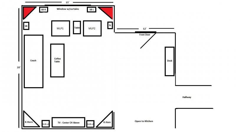

Let me ask you this; I used to have my living room set up in the config below. However, this was before I had 4 PSA subs to try to integrate. If I put it back this way, with the 2 subs by the TV as-is, and the 2 additional subs in the corners to either side of the MLP, do you see any major issues? Any thoughts on where the 4 subs would be best located in this config??
It's a lot of work to switch it back, but if it's going to net better bass I'm willing to give it a go. I know it provides better imaging from the KHorns. The only reason I changed it was WAF anyways.

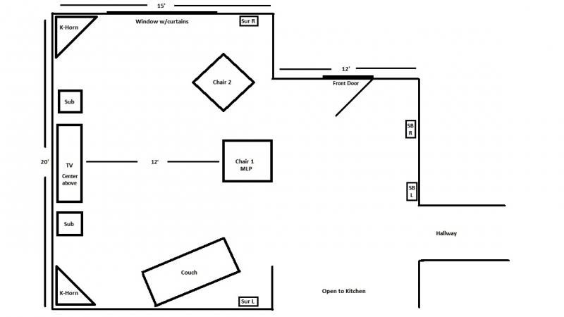

Here's a quick depiction. I used ms paint to make the changes so I was limited. Angle the chairs in at 45 degree s.

Good ideas there Garidy! I don't think the second one would fly with the wife, but the first one probably will. However, I do love my recliner and would be sad if it wasn't the MLP.
Are these pics just to demonstrate how to be in the correct position for the KHorns? Or, are these somehow related to bass as well??
That arrangement looks better mainly because the LP is much further away from the rear wall. BTW, where are you crossing at? With KHorns I'd almost think no higher than 50Hz.
Just some rule of thumb stuff that's aimed providing a reasonable experience for all and not just the one super sweet spot...
