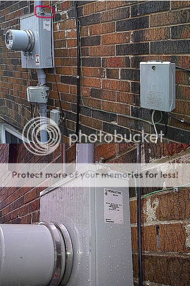

I took a photo of my outside cable box and traced a black cable (thinner gauge than the coax cables) that leads down and to the left (see photo below). Someone mentioned to me that this is probably the ground wire. Well, this cable ends unterminated and not attached to anything on the outside wall. So, if this is in fact the ground wire, then it's safe to say that I have an ungrounded cable wire??
If this is the case, I'll call my cable provider and see what they say. Where can they ground this wire though? They're not going to have to dig up my driveway to do this, are they?

If you have any pole going into the ground, that should work. However, I wouldn't be too concerned about it. Just get a grounding block or splitter and ground it before your equipment - in your house - which you may have to do anyway.
You can do this as well: http://www.ehow.com/how_2076406_grou...able-line.html
Here's a discussion on avsforum: http://www.avsforum.com/avs-vb/showthread.php?t=1128083

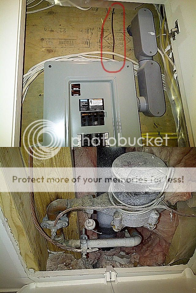

Thanks for the links. I've been doing a lot of reading and troubleshooting but I haven't found a solution yet. I called my cable company and they sent out a technician who connected a ground wire from the splitter on the outside of the house to a grounding clamp attached to my hydro meter as shown in the pic below:
This actually eliminated the hum I was getting from my two TV's that use a set top box. It did not, however, eliminate the hum and static noise I'm getting from my 2-channel (amp + preamp) and home theater (receiver + amp through receiver's pre-outs).
I then investigated the house ground and found the grounding wire coming out of my electrical panel, which goes up into the ceiling and which I assume comes out at the other end of the room where it is clamped onto the water pipes (see pic below). Now, the coax cable coming into the house feeds into a splitter - should i attach a ground wire to the ground wire coming out of the electrical panel? Would this create the "common ground" and eliminate ground loops?
I also bought a Viewsonic VSIS ground loop isolator (similar to the Jensen VRD-1FF), but it didn't have any effect on the hum.

Grounding to a copper pipe is normal in my experience, but I'm not an electrician. I'm just going by what I've commonly seen
Are your components all plugged into the same surge suppressor or outlet?
What about you sub woofer? `
Do any of your components have a grounding lug and are they in use?
When you disconnect your cable/satellite does the hum go away?
