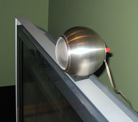

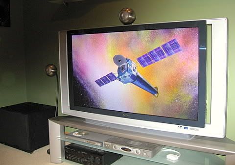

Following are a few images of the set up:
Entering the room--it's only 10 feet deep by 13 feet wide...
View of the subwoofer, front and center speakers, television and other components...
Television and stand with components...
The Anthony Gallo Micros are positioned in the ceiling...

First, larger, standard speakers for L/R.
Second, reposition and/or replace the center as well.
Third, acoustic treatment for bass and to absorb the first sidewall reflections.

Well, here's what I've done so far...
1- I moved the chairs 18 inches from the wall. This seemed to help with the rear surrounds.
2- I placed the center speaker above the screen. Previously, it was on the bottom shelf of the TV stand and was nearly on the floor. This made a noticeable improvement in sound quality.
3- I moved the subwoofer away from the far corner of the room. There was not a noticeable difference.
gnagel is offline
