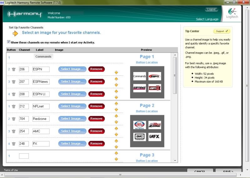

Hey guys, looked around the forum a bit and could find/missed what I'm looking for so I have a quick question.
Picked up a 650 today at a great price for a BF promo from BestBuy. I've used Harmony's for some time so I'm familiar with the interface and usage but one thing I cant figure out/change.
Can I remove, or at least move, the "commands" section from slot 1 of page 1 on my 650? I will never use it and would love to throw and extra favorite on page one?

You get favorites or commands but not both at the same time. If you can live without an icon, simply make a sequence for your favorite channel and add it to your commands. That's what we do on harmonys that don't have favorites.
I think the OP's question was whether the "commands" soft button could be moved to a different position, i.e. the last page. Or can it be removed all together?
If you check the "Show these channels..." box on the OP's screen shot, you get all channels and zero commands. So no commands can be added/moved/deleted in that case. If you uncheck the box, you get all commands and zero channels. If you want a mix of channels and commands, you have to uncheck the box and make a sequence for each channel and put it in any spot you like. Any command can be moved to any position or removed altogether. Note that this only works with the 7.7 software.
