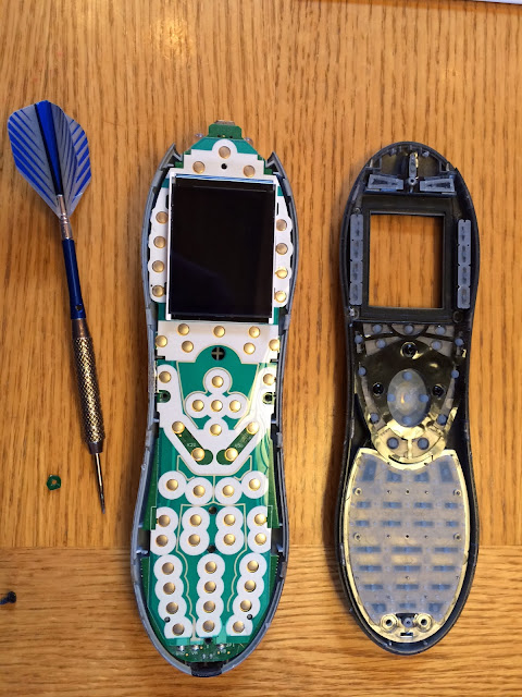

I put my DIY fix in this sticky also, as others may benefit to see it in a central location.
Issue: I have to press the "vol +" button really hard for it to raise the volume.
Update - Upon taking my 890 apart, 2 screws on outside back cover, then 2 screws on main logic board, instead of trying to "build up" the little silicone pushers that push onto the circuit board small contact buttons, I did something similar but much quicker and easier.
I decided to raise the circuit board so the button would have less travel to do, same effect.
So, I simply made a small washer from cardboard, a 12 can bottle cardboard.
I cut a small 1/4" by 1/4" square piece, used a dart to poke a hole in the center, then while the square piece was on the dart tip I simply trimmed it to a small round washer.
Non metallic, no danger of shorting anything.
For re-assembly, when I put the screw thru the main logic board, then I just pushed the small DIY cardboard washer onto it, the friction of the screw threads held the washer, and it so slightly propped up the circuit board upon final assy.
Did re-assembly, put battery in, re-boot....... and ta-da saved $100 at least from buying a replacement!
You can see work in progress here:
So, I give credit to this thread for inspiring my simple DIY fix, hope it help others.

I put my DIY fix in this sticky also, as others may benefit to see it in a central location.<br><br>
Issue: I have to press the "vol +" button really hard for it to raise the volume.<br><div class="quote-container" data-huddler-embed="/t/1185807/harmony-890-repair#post_24425806" data-huddler-embed-placeholder="false"><span>Quote:</span>
<div class="quote-block">Originally Posted by <strong>mtbdudex</strong> <a href="/t/1185807/harmony-890-repair#post_24425806"><img alt="View Post" class="inlineimg" src="/img/forum/go_quote.gif"></a><br><br>
Update - Upon taking my 890 apart, 2 screws on outside back cover, then 2 screws on main logic board, instead of trying to "build up" the little silicone pushers that push onto the circuit board small contact buttons, I did something similar but much quicker and easier.<br><br>
I decided to raise the circuit board so the button would have less travel to do, same effect.<br><br>
So, I simply made a small washer from cardboard, a 12 can bottle cardboard.<br><br>
I cut a small 1/4" by 1/4" square piece, used a dart to poke a hole in the center, then while the square piece was on the dart tip I simply trimmed it to a small round washer.<br>
Non metallic, no danger of shorting anything.<br><br>
For re-assembly, when I put the screw thru the main logic board, then I just pushed the small DIY cardboard washer onto it, the friction of the screw threads held the washer, and it so slightly propped up the circuit board upon final assy.<br><br>
Did re-assembly, put battery in, re-boot....... and ta-da saved $100 at least from buying a replacement!<br><br>
You can see work in progress here:<br><img alt="890-fix.JPG" class="bbcode_img" src="https://lh6.googleusercontent.com/-Kq-wrqXcA7s/UxIvVDNL5lI/AAAAAAAARQo/jLeKUgm4XHM/s640/890-fix.JPG"><br><br>
So, I give credit to this thread for inspiring my simple DIY fix, hope it help others.</div>
