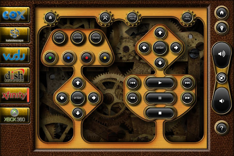

I've uploaded new backgrounds, including this one:
denass likes this.
