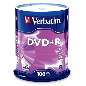

I finalized a DVD with this Panasonic DVD recorder. But the "finalized" DVD will not play in any other DVD player. My regular DVD player cannot play it, although the menu/chapter top page appears. My PC can't read this "finalized" DVD, and in fact, has crashed every single time I tried to play the DVD through my PC. Crashed so badly that the only way I could shut off or restart the PC was by pulling the plug out and then replugging.
The "finalized" DVD however, does play perfectly, without a hitch on the Panasonic DVD recorder.
Any advice?

An "unfinalized" DVD will play in a Panasonic DVD Recorder but not other devices.
Might you be confusing "writing to disc" with "finalizing?"
Press FUNCTIONS for a report of finalization status.
If "Not Finalized Disc" is reported you may finalized the disc by pressing OTHER FUNCTIONS, DVD MANAGEMENT, FINALIZE, YES and follow the prompts.

It's definitely finalized. There's a top menu. And when I eject the DVD from the Panasonic, I no longer get that message asking me If I want to finalize the DVD (by pressing the REC button).

Also anytime a unfinalized DVD is ejected in a newer Panasonic you will be prompted by the nag screen, DO YOU WANT TO FINALIZE THIS DISC? IF SO PUSH REC. It's also possible the DVD is somehow corrupt and only the Panasonic DVDR is able to play it.
Edit: DVDHARP responded while I was typing up the above, in that case I'd suspect a corrupt disc.
Oh lastly, it's not a RAM disc you have is it? RAM discs only play in limited devices. Most DVD players and some PCs won't play RAM discs.

The DVD is a Verbatim 97459 4.7 GB up to16x Branded Recordable Disc DVD+R (100 Disc Spindle)
http://www.amazon.com/gp/product/B00...00_i02_details

Were the recordings on the +R disc made in the XP 1 hour rec mode? Some older dvd players will sometimes choke on XP recordings, though a PC drive shouldn't.

I did not know that. Thanks for the info. Still, I recorded in the SP, 2 hr. mode.
