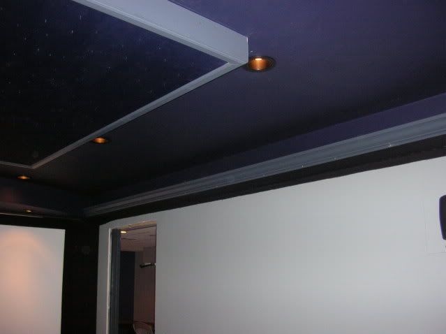

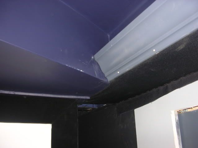

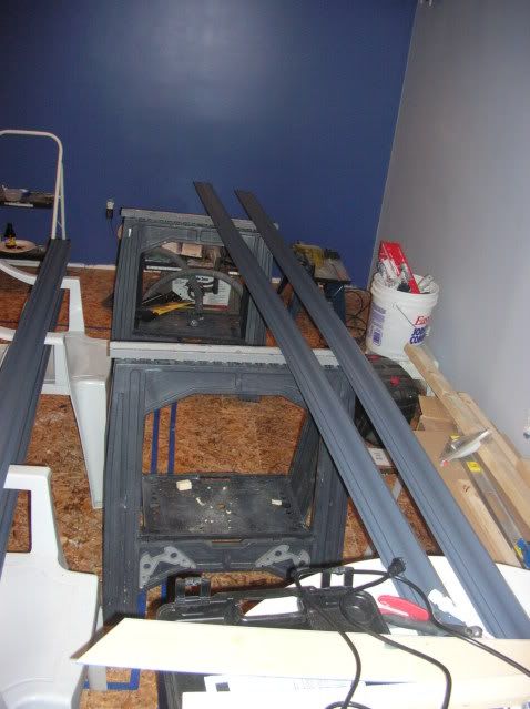

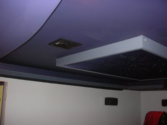

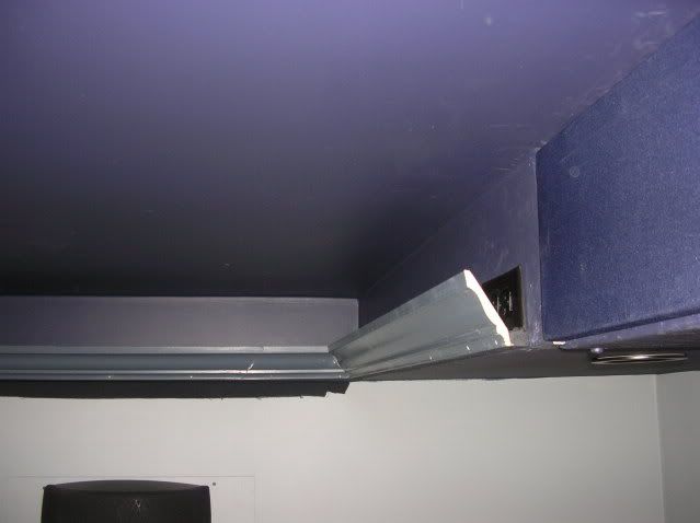

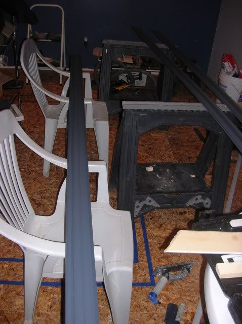

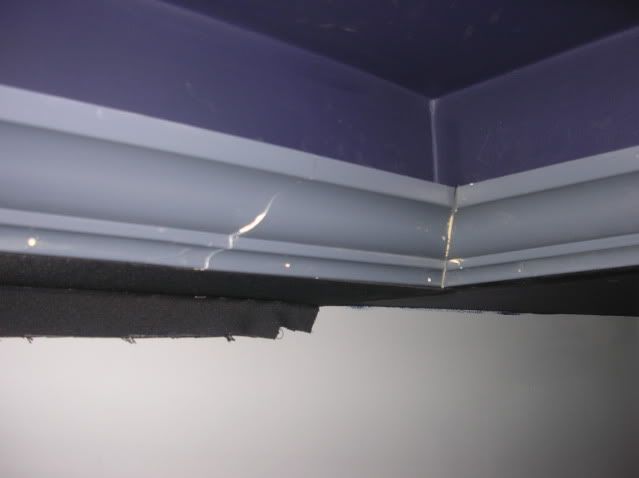

Finally get to post some pics from this weekends work. Friday picked up some crown and painted it on Saturday. No pics till now because literally it was watching paint dry...
I chose MDF crown because of the ultra smooth finish and the straight pieces I was able to get. My other choices were regular pine and finger joined pine (FJP). While I was able to find the latter in slightly longer pieces in order to avoid 1 small seam the finish on them was pretty rough and would have required a lot of sanding. Besides that they zig zagged, or arched, or bowed like crazy, so MDF it was.
Here are a couple of the crown pieces painted and ready to go.
Looking towards the front/entrance
Looking at the left back side when facing from the front
Closeup of the front against the curve stage soffit
close of the rear joint and the small seam. Both areas still need to be caulked and touched up with paint. Also you can't see the seam during regular HT lighting.
The angled section in the back where the outlet is. I still need to put the end piece there.
I still need to do the right side of the room, but overall it wasn't bad. The first few cuts were a pain and then I got on a roll. Then I got slowed down on the small piece in the back, but when it was said and done it looked pretty good.
The Mrs. still didn't seem too covinced on the crown and it's purpose, so I had to show her what it would look like with the rope light in it. I saw her smile when I lit it up and I knew that it was good
Please don't mind the rough look of the ceiling paint, it will be touched up after all is said and done.
post #532 of 1056
Looking good oman! Nice job on the 45s.
post #533 of 1056
Looking good.
The wife helped me with the crown molding and we were both very surprised with how well it went. It didn't take much time at all and I was glad she was there to double check me on the bevel/angle of the miter saw before I made each cut...
"Ok... it's a right inside corner... bevel should be at..."
I also ran a heavy bead of white caulk along the entire inside seam where the molding meets thwe wall to prevent light leakage.
post #534 of 1056
Ya the Mrs. was there to help lift and hold in place while I secured the long piece. She wanted to help with other things but she is in no way the person to confirm angles. Not to worry though, when I messed up a piece she was all over it...
I was also thinking about light leakage but I am not sure if I can get the caulking gun in at a good angle in all areas. I was thinking maybe duct tape, or real duct metallic tape to aid reflection as a side benifit. If all else fails maybe I could use the caulk stip that comes in a roll, thanks for the tip.
post #535 of 1056
I had the same issue with angles, so I got a few of the smaller hand squeezable tubes and skipped the caulking gun. I would run a 10' bead and then run my finger or a piece of cardboard along to smooth it out.
You look to have a similar amount of clearance to what I have.
I used some silver HVAC duct tape in a few areas as well (such as corners).
