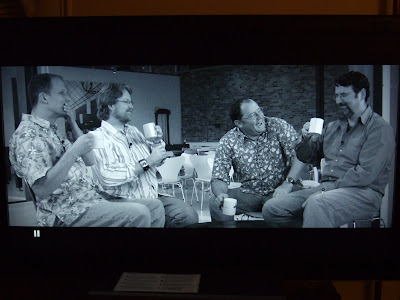

Based on what I saw in the 750 Calibration thread, I decided to try calibrating using warm1 instead of warm2, thinking that maybe it would help the colors get a little more accurate. Truth be told, it doesn't make much of a difference to me.

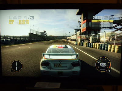

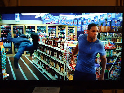

Sample images
Again, I think you'd be hard pressed to tell a difference between these settings and the 995 settings (though if you think one is better than the other, let me know!) Unless people think otherwise, I'm still suggesting the settings in post 995. And you all probably thought having a measuring device solved all your problems .

I truely appreciate your calibration work and effort. It is hard to judge between your 995 settings compare to the most recent, 1053, using the attacched pictures because they were taken at different day and time. I noticed the later were taken with the curtain closed, which produced different effect on pictures.
Below is the side by side comparison I put together, left = 995 vs right = 1053. I prefer your color settings from 995, which the blue contains less red in it. I applied 995 settings on my tv and made slight adjustment (I was using the Monster ISF HDTV Calibration wizard & TVBlink Test Tool) to the contrast (88) and brigthness (54). The outcome is excellent. You make us happy LN46A550 owners. Thanks a bunch.

Yea, the pictures were actually taken at different times of the day, so they may be a bit difficult to compare; I completely forgot about that.
